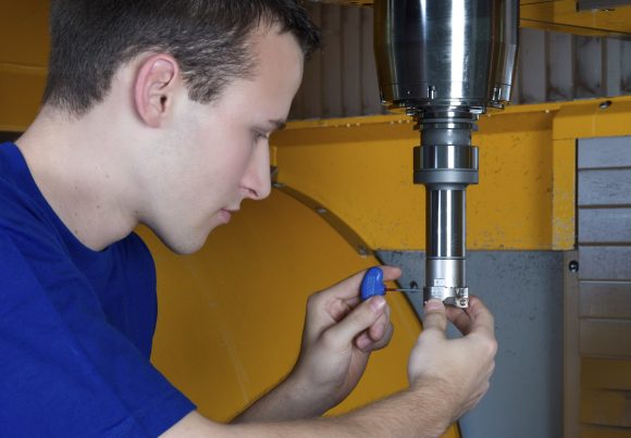

    Modular boring solution

    Compensate with digital boring heads
    For boring applications that require tight tolerances or where challenges increase the risk of oversized or undersized holes, digital boring heads can offer a bit of insurance and significantly speed up production. Digital boring heads allow operators to make high-precision adjustments faster and easier. What’s more, models like the EWE 2-152 digital fine boring head allow for variable length adjustment of the tool holder for the shortest, most rigid tool assembly.
