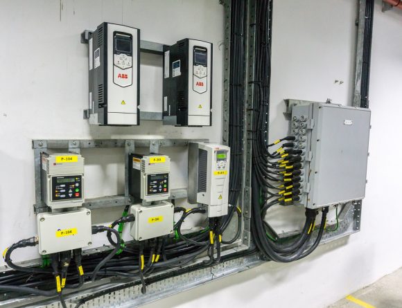

    Adoption of more sophisticated control techniques has increased the requirement for better process control, which can be found in equipment like VSDs. A VSD is an automation device that controls the speed, torque output or rotational force of motors, fans and pumps, by matching their speed and torque to the requirements of the application.
    More specifically, VSDs vary the input current and frequency during the start and stop cycle, and while the machine is being powered. This is carried out by converting the frequency and voltage input power to adjustable frequency and voltage sources.
    In most cases, VSDs deliver considerable energy savings. For example, using a VSD to slow a fan or pump motor from 100 per cent to 80 per cent can save up to 50 per cent of the energy used. Controlling the speed of a motor reduces energy usage during the highest energy consuming points, the start-up cycle, which requires extreme acceleration to power it at full speed.
    VSDs not only help reduce consumption during start-up, but also give manufacturers total control of engine speed in all phases of the motor, which reduces stress on the system, helping devices to last longer.
    Soft starters
    Soft starters provide control of a motor current to reduce inrush and limit shaft torque. As the name implies, soft starters are used only at start up and slowly let in increasing amounts of current, softly ramping up the speed of the drive and allowing for a gradual start. By gradually increasing the motor terminal voltage, soft starters produce a more regulated motor acceleration up to full speed.
    The steady approach to full power protects the motor from torque spikes and sudden tension and reduces motor heating, helping to extend equipment life.
    Some soft starters use solid state devices to help control the flow of current, whereas a reduced voltage soft starter helps protect the motor and connected equipment from damage by controlling the terminal voltage. This limits the initial inrush of electrical current and reduces the mechanical shock associated with motor start up.
    In industrial plants, soft starters are often used in conveyor belts to steadily adjust torque to the necessary level. Without this control, sudden tensions could deteriorate the belt and cause it to snap due to mechanical stress.
    Application considerations
    While both VSDs and soft starters deliver greater process control, before taking the steps to upgrade a plant, it’s critical to assess the application, system requirements and cost for initial start-up and life cycle of the system.
    VSDs are significantly larger and therefore up to three times more expensive than soft starters. This initial cost must be considered, as well as maintenance and replacement costs. However, VSDs can provide energy savings of up to 50 per cent, which can deliver better return on investment (ROI). However, if constant acceleration and torque control is not necessary, and an application requires current limiting only during start up, a soft starter may be a better solution.
    Now, let’s look at some specific applications for each. VSDs are ideal where complete speed control is optimal. As VSDs can reduce power when it is not required and increase it whenever it is needed, they are particularly beneficial in manufacturing scenarios where equipment is used for multiple processes. Take for instance a food processing facility that requires different cooking temperatures and fans that need continuously adjusting to monitor cooling.
    Soft starters are most beneficial where speed ramping and torque control are desired primarily when starting or stopping, such as conveyors, belt driven systems and gears. In addition, soft starters are also suited to piping systems that need to avoid pressure surges when fluid changes speed too quickly.
