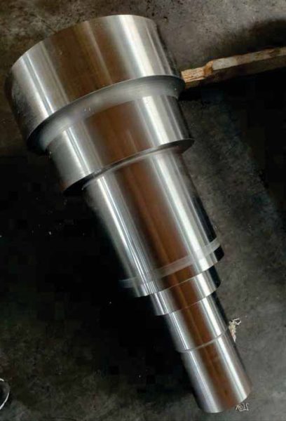

    Near net shape forgings are seamless rolled rings or open die forgings with dimensions close to the final shape of the finish machined part. “As forged” components, on the other hand, often have a coarse surface finish (500 RMS or more) and may include metal scales and very uneven surfaces that must be machined away. This increases the cutting time, tool wear, and cutting fluid used, which eats into profits. When a customer is on a tight budget, extra stock material that becomes metal swarf can mean the difference between winning a job and losing one.
    Fortunately, near net forgings are available with tolerances within 3mm on all dimensions and a much finer surface finish. Although the initial price may be higher, the reduced machining time, wear, elimination of waste, and faster delivery time to the customer translate into cost savings and profit improvements. Reduced machining time increases machine availability for additional projects as well.
    Near net forgings are more than just ODs, IDs, and lengths. They include steps on round shafts, blocks, squares, rectangles, hubs, wheels, cylinders, blind cylinders, flanges, drive ends, tending ends, and complex shapes. All Metals & Forge is an ISO 9001:2015 and AS9100D-certified manufacturer of open die forgings, seamless and contoured rolled rings, and complex forged parts with stock allowances or near net shape tolerances.
