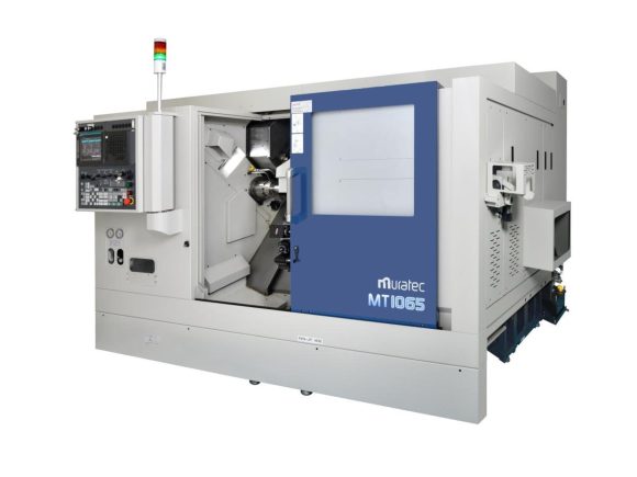

    Charlotte, NC – (February 26, 2025) Murata Machinery USA (Muratec USA), a pioneer in machining and a world-class leader in automation, announces the North American premiere of its innovative MT1065EX, at the Precision Machining Technology Show (PMTS) 2025, booth 3073, held April 1-3 in Cleveland, Ohio. Engineered for exceptional speed, accuracy, and versatility, the MT1065EX is set to redefine bar-fed machining applications with its advanced twin-spindle, CNC turning capabilities.
    Designed for bar-fed machining applications, the MT1065EX features two spindles and two live-tool turrets, with Y-axis functionality in the upper turret for enhanced versatility. It accommodates 6 or 8-inch chucks powered by an 18.5-kW left spindle motor and a 15-kW right spindle motor, ensuring robust performance across demanding applications.
    Each turret offers 12 tool stations with 24 index positions, allowing independent machining operations or synchronized pinch-turning and milling. The MT1065EX’s compact design optimizes floor space while delivering superior machining capabilities.
    “The MT1065EX represents the next evolution in CNC turning technology,” said Jeff Kalmbach, General Manager of Muratec’s Machine Tools Division. “This machine’s combination of dual spindles, live-tool turrets, and advanced thermal compensation provides unmatched accuracy and operational flexibility, making it an ideal solution for both high-volume and high-mix, low-volume production environments.”
    Key features of Muratec’s MT1065EX Twin Spindle CNC Turning Center:
    • Thermal Compensation System: Equipped with 11 strategically placed sensors, the MT1065EX maintains long-term stability and accuracy during extended operations.
    • Versatile Axis Configuration: Both turrets can access either spindle, enhancing operational flexibility.
    • Cutting-Edge Software: Simplifies programming, optimizes tooling paths, and reduces material waste while integrating production scheduling and real-time monitoring.
    • Compact, Flexible Design: Configurable chip conveyor supports right-side or rear discharge for seamless shop integration.
    “Manufacturers today demand more than just speed and precision—they need solutions that optimize every aspect of their operations,” added Kalmbach. “The MT1065EX does exactly that, helping shops reduce cycle times, minimize waste, and boost overall productivity.”
