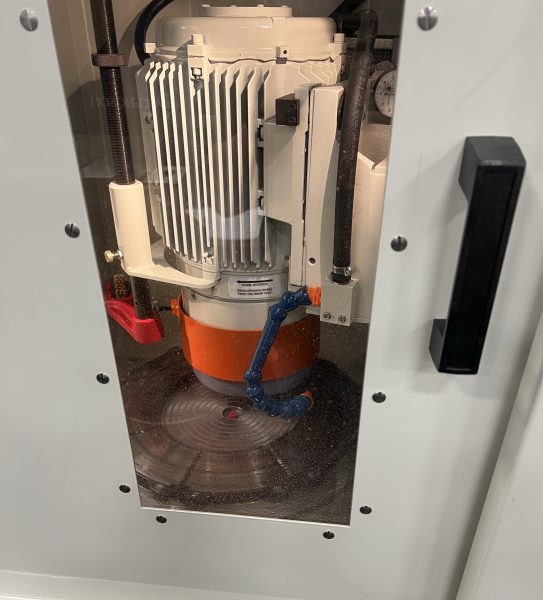

    According to Anderson, the machine most often selected for aircraft brake rotor grinding is DCM Tech’s IG 080 M, which is economical and ideally sized to handle large aircraft rotors. The grinder includes an 18” diameter variable strength electromagnetic chuck that quickly and securely holds brake rotors of various sizes during processing.
    The surface grinder holds the workpiece firmly in place on a rotating table underneath a vertical spindle. Unlike conventional grinders, the grinding is not performed by the peripheral edge of the wheel, but by the entire diameter of the abrasive surface. Anderson says this is similar to a lawn mower blade that can cut a wide swath of grass versus a blade run on its end, which will only cut a narrow strip.
    “The eight-inch abrasive wheel more than covers the cross section of the rotor between its ID and OD for complete grinding of the rotor surface,” says Anderson.
    “To expedite the maintenance or overhaul, the grinder provides an automatic feed system, so the machine can continue running without further operator oversight once it is started,” adds Anderson.
    A unique demag (demagnetization) function on the electromagnetic chuck ensures that before the brake rotor is released from the machine, any residual magnetism is dissipated.
    “This can be valuable for MROs, because if any magnetism remains in the rotor, it might attract magnetic material that could have a negative effect on the brake pads once installed,” says Anderson.
    The machine is available with a low open shroud or fully enclosed shroud. The full enclosure contributes to a cleaner shop environment by containing the debris and preventing it from entering the work area. The shroud, which is a sliding door with a built-in window for viewing the process, has the added benefit of reducing the noise produced by the machine. The enclosure also includes a safety door interlock, viewing window, work light and mist collector unit.
