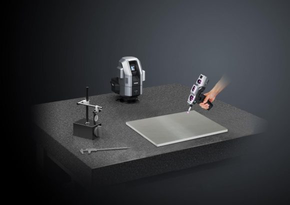

    The XM-5000 supports TCI Precision Metals’ need for flexibility and accuracy. Precision blanks can be measured and verified to close tolerances on the bench or in process. Blanks are checked for dimensional accuracy, squareness, parallelism, and flatness. The portability of the measurement solution supports moving it to the most efficient location for use. Quite often, customers request additional features be added to ordered blanks. This might include holes, hogouts, or other time-consuming processes. The ability to move the measurement solution to the most efficient location saves time.
    The Keyence XM-5000 can measure blanks as large as 78.74″ × 47.24″ × 39.37″ (2000 × 1200 × 1000 mm) with an impressive accuracy of ± (7 + 9L/1000) µm. The measuring head can be installed on the stage and on a dedicated mount or tripod. This allows the CMM to be placed anywhere for maximum flexibility.
