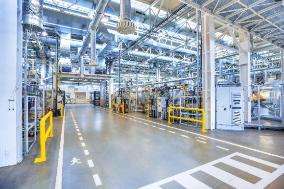

    High operating costs, rising inflation, aging plants that need capital investment, or simply corporate restructuring: these are all reasons business leaders choose to shut down aging mills or plants that have become regional icons. Whatever the rationale and public response, plant owners are still left with the question of how to minimize losses by preserving asset value for resale and future use. One of their most unrelenting enemies is corrosion, which threatens to consume more and more value the longer the plant remains idle. Cortec® corrosion solutions are here to provide practical and cost-effective answers to these asset preservation challenges.
