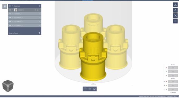

    Campbell, Calif.—Feb. 28, 2023—Velo3D, Inc. (NYSE: VLD), a leading metal additive manufacturing technology company for mission-critical parts, today announced the latest release of its Flow print preparation software. Flow 5.0 unlocks an array of new capabilities for engineers using Velo3D’s fully integrated solution including user-selectable core parameter sets that provide enhanced control over builds with the ability to assign different parameters to any part on the build plate. This improvement, in addition to Flow’s ability to apply skin and contour overrides, gives customers enhanced control over the final material properties of printed parts.
    “Through our software, we are able to continually expand our manufacturing capabilities based on customers’ needs and feedback,” said Alexander Varlahanov, VP of Engineering at Velo3D. “By enabling selectable core parameters for customers, engineers can modify the material properties of their parts to better suit the need of the application, including more isotropic parts. This even works on builds with multiple types of parts where each requires a different core parameter set.”
    The new Flow 5.0 release also includes checks and messages that identify possible errors before a build even starts, reducing the likelihood of customers experiencing failures in their builds. In doing so, engineers can be confident that a part will print successfully before the process begins. Flow also now includes labeling for objects. Customers can easily add alphanumeric characters, like serial numbers or other unique identifying text, to their builds within the Flow print preparation software to clearly identify and label instances of their parts. Once the print file is produced, the characters can be updated through a new Label Updater tool.
    The release also enables a faster method to calculate build times for builds of different part quantity. After a part has been prepared for print, users can vary the quantity of that part and see updated build times to better understand the economics of scaled production. This enables contract manufacturers to speed up their quoting process and accelerates OEM planning and scheduling.
    The Flow print preparation software is a key part of Velo3D’s fully integrated metal additive manufacturing solution. The software takes traditional CAD files and turns them into print files without any specialization or design for additive manufacturing (DfAM). Other parts of the solution include the Sapphire family of printers, Assure quality assurance software, and the underlying Intelligent Fusion manufacturing process that ensures consistent, repeatable outcomes across different Sapphire printers from the same print file.
