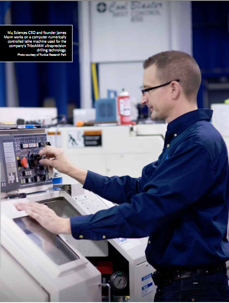

    A technology developed by professors W. Dale Compton and S. Chandrasekar at Purdue University School of Industrial Engineering, West Lafayette, Ind., enables faster drilling, without peck cycles. Modulation assisted machining (MAM) oscillates a drill in a controlled motion, up to 1000 times per second. This produces an intermittent drilling action that cuts consistently small chips, which easily flush from the hole. It also enhances lubrication.
    M4 Sciences, West Lafayette, Ind., is commercializing this technology in its precision TriboMAM drilling system and custom modulation-assisted machining devices.
