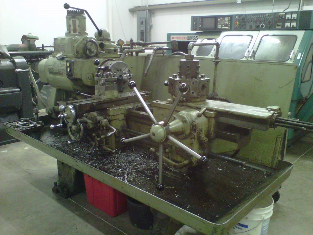

    By this time my lovely bride is in tune with my mental condition and softly offers to run up to McDonald’s and bring me something back. Okay, I’m running out of time, I don’t have a lathe with a large enough hole for the 6″ eye to sit in the spindle so I can thread, you know, spot a center, and hold with the tailstock, and single point. Obviously, I can’t cut the thread with a geometric head, because I can’t chuck up the part.
    Then all of the sudden, while staring at my old girl in the back, (no, not Laura) the redneck rocket scientist in me kicks in. Who’s the old gal you ask? Well she is my old Warner & Swasey #4 turret lathe. She’s old, she’s green, she’s a ram type, and she’s not easy on the eyes, but damn she’s one of the most useful pieces of iron ever made. I quickly fasten the ¾” Geometric head in the 10″ Cushman chuck, I then move the turret saddle all the way back. I grab a ER-32 collet drill holder and fasten the part stationary through the turret hole and into the drill holder on the other side.
    I’m thinking I’ll spin the Geometric head in the chuck and feed the part through, tripping the dead stop on the turret. I’ve never tried this before, but what choice do I have? Well, in about 30 minutes we had 10 beautiful ½-13 threaded 316 SS I-bolts. Danny said, “Damn I knew ’em screw machines could do it.” Whew, and another one bites the dust.
