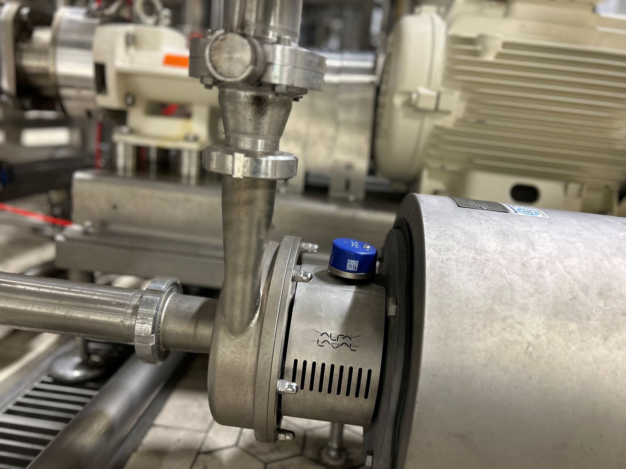

    Using Alfa Laval’s condition monitoring solution, the company identified an imminent pump issue that otherwise would have gone unnoticed until failure occurred. Acting on a single notification, the maintenance team repaired the defect pump during a planned production stop and avoided six hours of unplanned downtime as well as 288,000 bottles of lost product and 2,000 litres of cleaning water.

    Within months of implementation, the condition monitoring system detected abnormal operation on a critical pump and alerted operators before failure occurred. The maintenance team was then able to complete the repair in just 45 minutes within a planned production stop, avoiding six hours of unplanned downtime.

    ClariotTM is Alfa Laval’s AI-based condition monitoring solution developed specifically for hygienic process industries. The solution continuously monitors pumps and other rotating equipment, providing 24/7 analysis, diagnostics and alerts that enable maintenance teams to address issues in time.
    Built on Alfa Laval’s experience from more than 3,000 condition monitoring installations worldwide, Clariot combines intelligent sensors, advanced AI-based analytics and secure connectivity in a complete monitoring platform that can detect issues related to process conditions, installation issues and mechanical wear.
