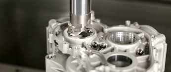

    Get extra help for long-reach applications
    Hard-to-machine materials often come with other challenges by nature of the applications they serve. Large, complex aerospace or automotive workpieces, for instance, often require long-reach boring. It’s a double whammy for operators trying to manage hole quality and tool life. Extended-length tooling assemblies increase the risk of vibration and chatter, which can worsen the work-hardening effect and compromise bore quality.
    There’s a helping hand in the form of BIG DAISHOWA’s Smart Damper technology. The system damps vibrations and reduces chatter in deep-hole finish boring for more effective cutting and smoother hole-making. In fact, these damping qualities can counteract the need for traditionally slow cutting parameters in precision deep-hole boring, allowing operators to greatly improve cycle times—as much as tenfold.
