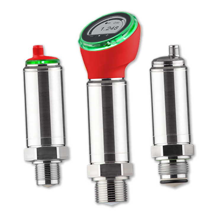

    BinMaster’s newest compact non-contact radar level sensors provide smart inventory control in a small stainless-steel housing, designed for food, beverage, and pharmaceutical manufacturing.
    At just 6” in length and 1.5” diameter, CNCR-400 sensors are ideal for small processing vessels including bins, tanks, hoppers, and mixers with agitators. 80 GHz radar technology provides accuracy within 5 mm—even in turbulence, condensation, and buildup—ensuring precision and performance throughout sanitary processes.
    The CNCR-400 radar series are offered in three different models. Each hygienic sensor measures bulk solids and liquids within ranges up to 49 ft. (15 m):
    • Digital Display (DD): Features a digital readout on the sensor face, plus a light ring with programmable colors for visual alerts
    • Light Ring Indicator (LRI): Includes a light ring with ability to program colors to alert to critical high or low inventory conditions
    • Stainless-Steel Only (SS): Ideal for vessels where local alerts or visual cues are not a requirement; a cost-effective option for continuous process monitoring
    Compatibility with BinCloud® inventory management software differentiates the CNCR-400 radars from other brands of compact radar sensors. Users can view bulk material levels in real-time, from anywhere, on a phone, tablet, or PC. From one site to multi-national operations, operators can view inventory  for every bin and plant location from one login and easy-to-use interface.
    CNCR-400 sensors include 4-20 mA, NPN/PNP, and IO-Link outputs. Setup and configuration are simple using a  Bluetooth application on a cell phone. Radars are rated IP66/67/69 for long-term durability, offer .75” and 1” NPT connection options.
    The compact level sensors include standard c-UL-US ordinary location approvals, plus FDA, 3A, and EHEDG worldwide hygienic approvals.
