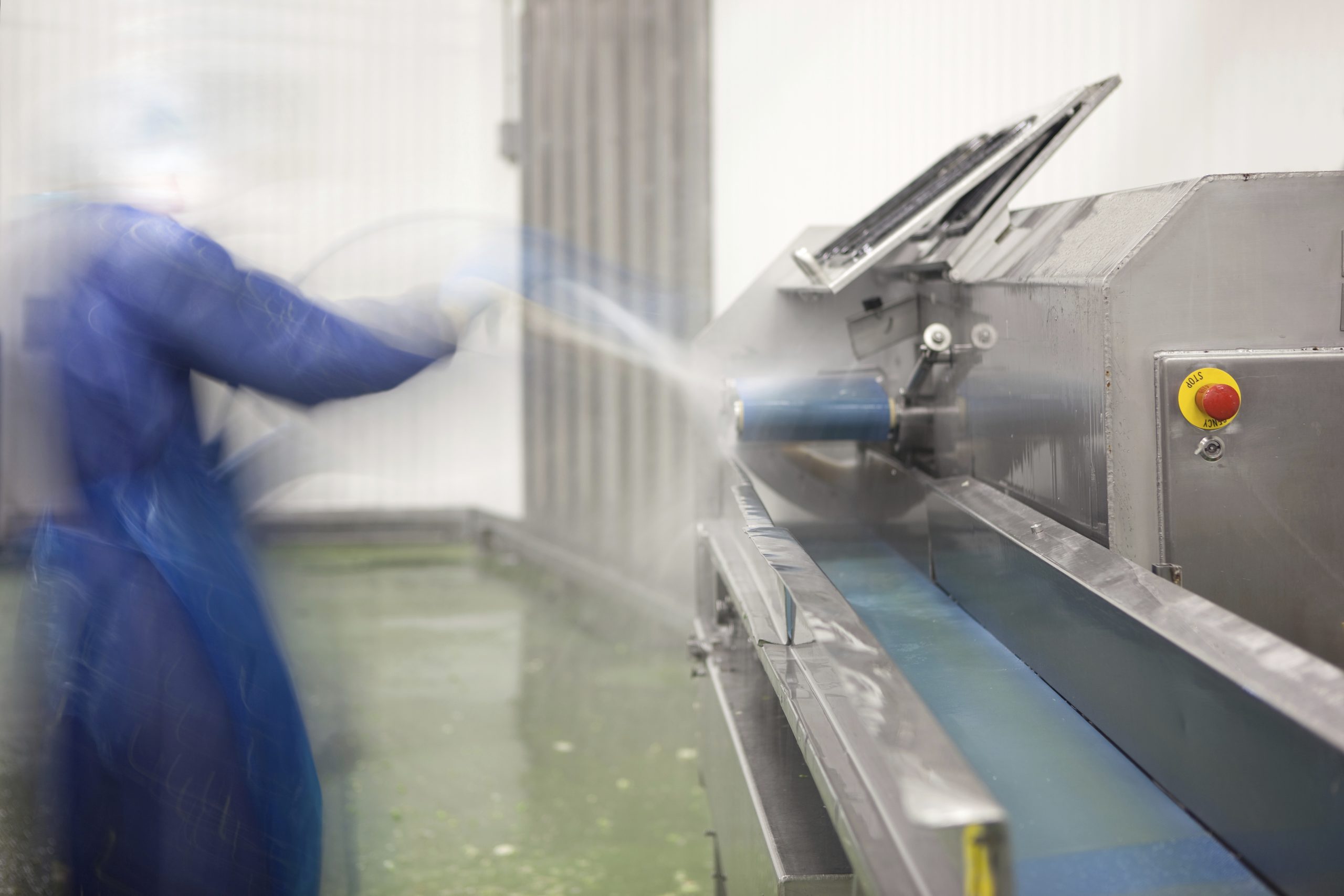

    Modern hygienic designs allow cleaning in place, reducing both contamination risk and downtime.

    That distinction matters because different sectors place very different demands on motion hardware. In hygienic applications such as food processing, pharmaceutical production, and some lab automation systems, the challenge is not simply keeping water out. Equipment must often be cleaned regularly with pressurized water and chemicals, sometimes at high temperature, and the motor has to survive that process without becoming a hygiene risk itself. In these environments, ingress protection is closely tied to cleanability. A motor housing with sharp edges, hidden crevices, or poorly protected interfaces may be difficult to sanitize, even if its sealing performance looks strong on paper.
    Protection is about more than sealing
    This is why hygienic motor design extends beyond the IP code. Older machine designs often placed a standard motor inside a protective enclosure that could be cleaned externally. While workable in principle, that approach created an enclosed internal space that could not be washed down directly, making thorough cleaning of the motor itself difficult. More recent hygienic designs avoid that compromise by allowing cleaning in place, reducing both contamination risk and downtime.
