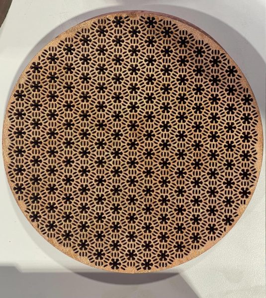

    Copper is one of the “hottest” metals attracting attention in the additive-manufacturing world these days. This is in large part due to its superior thermal conductivity, which is desirable in rocketry and industrial applications such as electronics, where heat exchange is critical. That capability stems from the copper atom’s single, free electron in its outer shell that can transfer a high level of energy over a distance with little-to-no resistance. Small amounts of copper can be found in nugget form, but most of what’s used today is smelted out of mined ore.
    Second only to silver among metals in its ability to conduct heat, copper is also pound-for-pound significantly less expensive, which is attractive to rocket developers. In its pure form copper is relatively soft; for the more advanced 3D-printing purposes it’s usually mixed with other metals into alloys that provide enhanced mechanical properties along with that valuable conductivity. Common copper alloys for AM include GRCop-42 and GRCop-84 (both are copper chromium niobium), C18150 (copper, chromium, zirconium), C18200 (copper chromium), and GlidCop (copper and alumina). The color of copper alloy powders is a soft pink, with finished AM parts displaying that classic, copper-color glow.

    But it wasn’t until LPBF became available—and with enough laser power to work with copper— that copper powder found its ideal match in advanced AM technology. Carried out in an airtight build chamber, LPBF is the manufacturing process that can deliver the extremely complex internal geometries being developed for the latest rocket combustion-chamber designs, or for cold-plate applications in electronics.
    These AM-enabled complex geometries are of particular interest to engineers designing lighter-weight rockets with novel propulsion configurations for launch vehicles, hypersonics, and other applications. A rocket’s thrust chamber needs to have material properties that can withstand the thermal and pressure extremes of ignition. But because it is essentially functioning as a heat exchanger, the chamber must also withstand a surrounding flow of super-chilled rocket propellant. Such a fluctuating environment can be balanced with extreme precision by 3D printing intricate cooling channels in the surrounding walls of the thruster—with geometries that cannot be achieved via any other type of manufacturing. The best material for this kind of system? Copper, of course, lining the combustion chamber.
