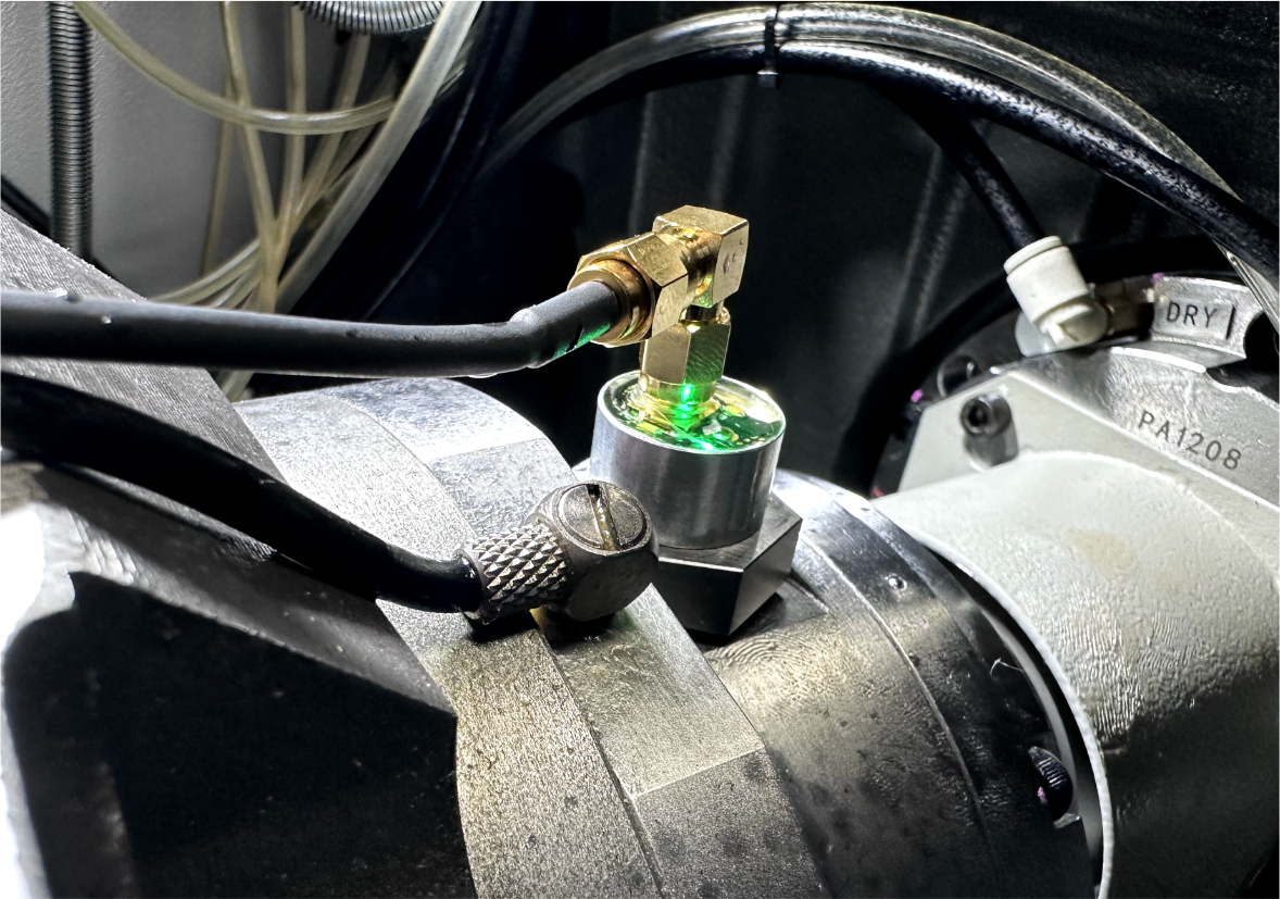

    In the precision-driven world of CNC machining, material loading with bar feeder technology can be essential for process automation—but automation without real-time control can quickly lead to scrap, downtime, and equipment damage. Caron Engineering’s DTect-IT product features robust vibration detection and monitoring capabilities designed to identify and respond to excessive bar feeder vibration before it impacts part quality or machine health.

    DTect-IT uses a high-resolution vibration sensor mounted on the main spindle to continuously monitor vibration signals during cutting. When vibration exceeds user-defined thresholds:
    • Automatic Spindle RPM Adjustments: The system signals the CNC to reduce spindle RPM incrementally until vibration falls within acceptable levels—keeping the process within tolerance and preserving part quality.
    • Emergency Stop Capability: If excessive vibration cannot be corrected through RPM adjustments, DTect-IT commands the CNC to stop, preventing equipment damage and unnecessary scrap.
