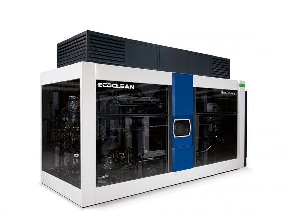

    With the EcoCcore, Ecoclean will showcase a cleaning machine, which sets standards in solvent-based cleaning. The fully enclosed system is designed to for the efficient cleaning of large quantities of parts to meet tight cleanliness specifications. It works either with non-halogenated hydrocarbons or modified alcohols. The base EcoCcore system owes its performance to a feature packed standard equipment list which comprises, e.g., two flooding tanks, heat recovery, full-flow and bypass filtration, plus assorted details minimizing non-productive cycle times. In addition, the machine cuts per-unit costs due to its high throughput while achieving
    a superior cleaning quality at the same time. This high quality is attained, among other factors, by an innovative preliminary steam degreasing technology wherein the oil-containing solvent, contrary to common practice, does not end up in the flooding tank but is directed straight into the distillation unit. The steam pre-degreasing step also provides advantages where high oil input rates are encountered and in cases where the second flooding tank is used for a corrosion protection treatment. For applications in which coarse and fine cleaning as well as corrosion protection is required, it can be equipped with a third flooding tank. The optional automatic loading unit enables fully automated cleaning processes. For the ultra-fine degreasing treatment that commonly follows wet chemical cleaning with a solvent or aqueous medium, Ecoclean offers an innovative plasma solution. It permits an additional low-pressure plasma cleaning step to be performed in the cleaning chamber of the wet cleaning system, e.g. EcoCcore. By means of this combined cleaning cycle, the free surface energy that is key to optimum adhesive strength can be raised to 50 to 80 mN/m in virtually one single process.
