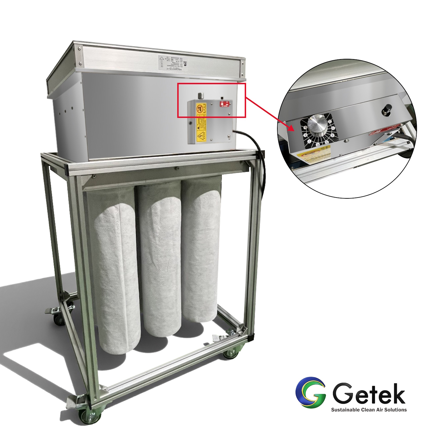

    Tainan, Taiwan, August 28th, 2025 – GE Technology Inc. (Getek) announces the launch of the ACU portable air clean unit. ACU combines high-efficiency particulate control with customizable molecular filtration in a self-contained mobile unit, offering a solution for indoor air quality and controlled-environment contamination control in both commercial and industrial settings.
    Engineered for Beyond-HEPA and Targeted Molecular Control
    Unlike conventional portable air cleaners limited to HEPA filtration and generic carbon media, the ACU offers ULPA-class particulate options for beyond-HEPA performance and refillable, site-specific CHEMSORB™ chemisorptive blends. This combination targets airborne molecular contaminants (AMC) that standard design/absorbents cannot address, while reducing consumable waste and supporting ESG objectives.
    Portable Unit for Rapid Deployment in Multiple Environments
    ACU’s mobile design enables fast relocation to address localized contamination wherever it occurs. Air enters from the bottom, moves vertically through the unit, and exits from the top for efficient air distribution. Four casters, including four locking wheels, allow for easy movement and secure placement. Configurations can range from general ambient air cleaning to ultra-high filtration for cleanrooms and critical production areas.
    High-Efficiency Particulate Filtration (HEPA/ULPA)
    ACU supports HEPA H13 and optional ULPA stages, delivering up to 99.999% particle removal efficiency at MPPS. This makes it suitable for occupational health protection, infection-risk reduction, and process-critical cleanliness.
    Molecular Air Filtration with CHEMSORB™ Technology
    The lower chamber houses Getek CHEMSORB™ media in refillable trays (CHEMSORB-R), pleated (CHEMSORB-P), or sponge (CHEMSORB-S) formats. Depending on the blend, CHEMSORB targets acids, bases, molecular gases, VOCs, ozone, reactive compounds, and boron-/phosphorus-containing gases.

    • Airflow (typical HEPA configuration): ~1,100 m³/h (≈ 650 CFM) at face velocity ≈ 1.0 m/s
    • Particulate stage: HEPA H13
    • Molecular stage: CHEMSORB-R / -P / -S; media performance per ANSI/ASHRAE 145.1 where applicable
    • Airflow control: Adjustable via manual settings
    • Power: 210 W @ 220 V, 60 Hz; single phase (optional 100–240 V, 50/60 Hz)
    • Dimensions/Weight: 670 W × 670 D × 1240 H mm
    • Mobility: 4 casters (4 locking)
