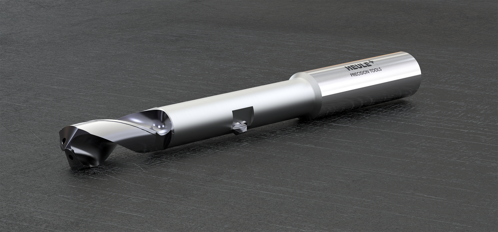

    (Loveland, OH) Heule Precision Tools, a leader in precision hole finishing technology, introduces VEX tooling which drills and chamfers in a single step, for increased efficiency and precision. Designed with a solid carbide tip and patented SNAP chamfering system, VEX tooling is available from 5mm to 17mm. Regardless of size, a convex cutting edge ensures high drilling performance and short manageable chips, even in long chipping materials. With the ability to drill and chamfer through-holes in a single operation, VEX eliminates tool changes to bolster productivity and efficiency, while improving quality. A specially developed connecting system features a robust and precise attachment to the tool body, for optimum power transmission and overall performance. VEX tooling is ideal for high production, precision environments like automotive manufacturing, especially on brake discs, tube applications, wheel hubs, and more.
    A large chip channel optimizes swarf evacuation, enhancing cleanliness and safety. Drill tip and chamfer blade replacement can be accomplished easily without presetting between changes, to minimize maintenance downtime.
    The replaceable drill tip of the VEX can be reground and recoated, thus extending tool life and lowering overall tool costs. Stock sizes from 5mm to 17mm are available for immediate delivery; custom designs are available to meet specific industry applications.
