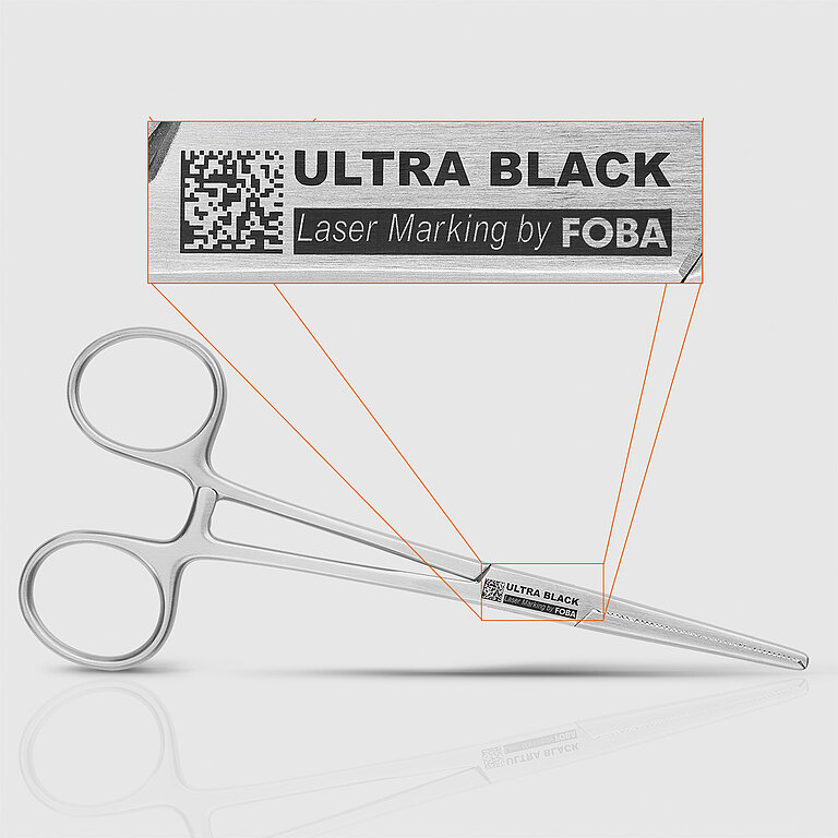

    Black marking refers to a laser marking effect that produces deep black, matte, non‑reflective marks. A defining characteristic is angle‑ and illumination‑independent readability: the marking appears uniformly black regardless of viewing angle or lighting conditions. This is particularly relevant for vision‑based inspection processes and for reliable machine readability of DataMatrix codes commonly used for UDI marking.
    “The black appearance is not created by material removal or a thermally generated oxide layer, but by a nanostructure on the surface. These so‑called ‘light traps’ reduce reflection, producing a strong contrast,” explains Damian Zawadzki, Product & Application Manager at FOBA Laser Marking + Engraving.
    Black marking is typically performed using ultrashort pulse (USP) lasers. With ultrashort pulses in the femtosecond and picosecond range and high pulse energy, the nanostructures required for the black‑marking effect form with virtually no heat input. Because the pulse duration is extremely short, very little energy is transferred into the surrounding material, often described as “cold” laser marking.
    That long‑term durability can be demonstrated under realistic conditions is shown by extended testing conducted by medical technology service provider add’n solutions together with FOBA Laser Marking + Engraving. Stainless steel instruments marked using the black‑marking process  were repeatedly reprocessed (cleaning/passivation in a fully automated system, autoclaving, and additional highly alkaline cleaning intervals). The outcome: after 1,000 cycles, the markings created with the ultrashort‑pulse laser FOBA F.0100‑ir remained reliably legible. “The marking is still excellently readable. It outlasts the service life of an instrument. In our test instruments, the material failed before the marking did,” states Dominik Pfeiffer, add’n solutions.
    In summary, and in relation to the four challenges above, USP laser black marking combines: reflection‑free contrast generation, high precision for miniaturized codes, extremely minimized heat input to protect the material, and strong resistance to cleaning, disinfection, and sterilization processes.
