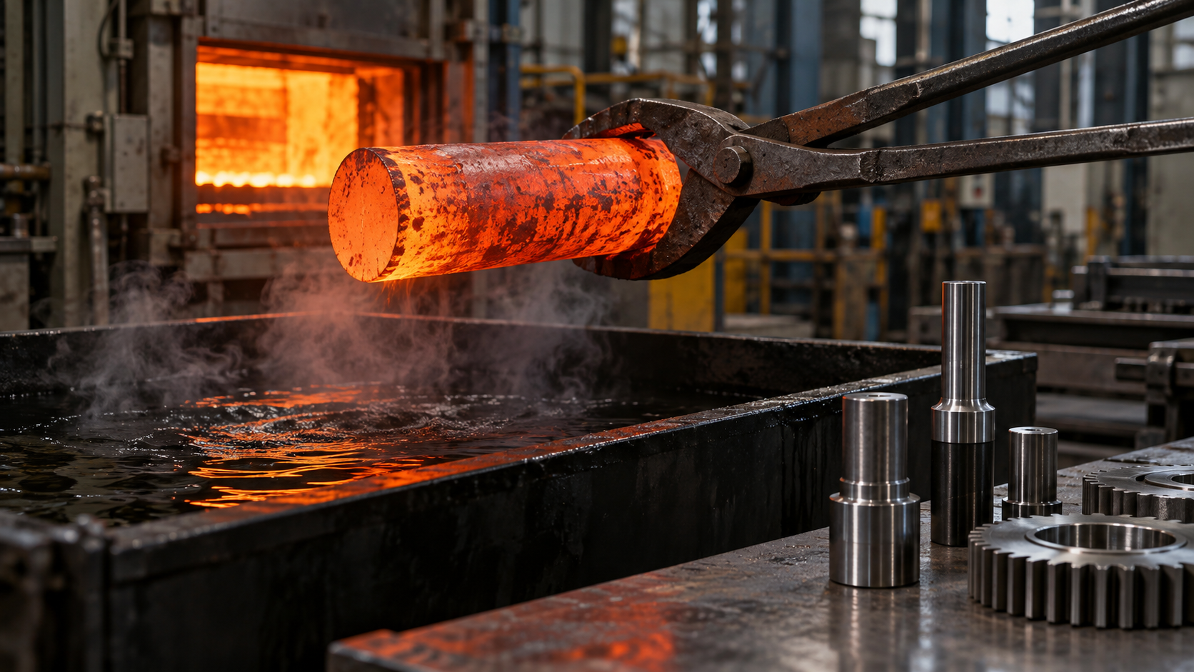

    The Quench Is Where Hardness Comes From
    Heating steel past its critical temperature dissolves carbon into a structure called austenite. Cool it fast enough and the carbon gets trapped in martensite, which is extremely hard and, straight out of the quench, about as forgiving as glass. Cool it too slowly and the steel forms softer structures that may not meet a part’s wear or strength requirements.
    Each grade wants its own quench. Water and brine are fast and harsh. Oil is gentler. Air-hardening tool steels like D2 harden in still air, which helps with distortion. Parts with uneven cross-sections pose an extra challenge: thin sections cool much faster than thick ones. That mismatch creates stresses that can cause warping or quench cracks in tools, shafts and other machined components. Overheating before the quench causes its own trouble. The grain coarsens, and the finished steel can become brittle no matter how carefully it’s tempered.
