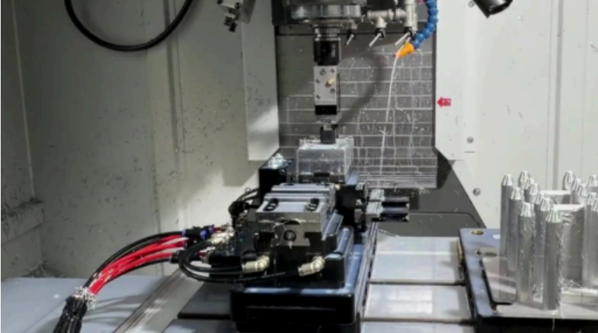

    Step 1 in action — the spindle gripper loads raw stock into the Op1 AutoVise™ while finished parts accumulate in the loading tray. The entire cycle runs unattended inside the machine enclosure.

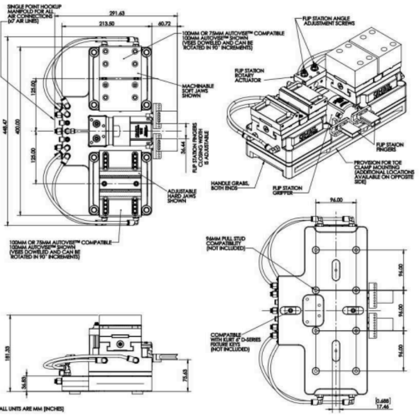

    The module is a single integrated pallet that bolts to your machine table. It contains three critical subsystems on one manifold base:
    1. Op1 AutoVise™ — A self-centering pneumatic vise that clamps raw stock for the first operation
    2. Integrated QuickFlip180™ Station — A pneumatic part-flipping mechanism built directly into the pallet
    3. Op2 AutoVise™ — A second self-centering pneumatic vise with machined soft jaws that receives the flipped part for the second operation
    All air routing is integrated through the pallet itself — seven air lines exit the front of the module
    and connect to solenoid valves controlled by your CNC program’s M-codes.

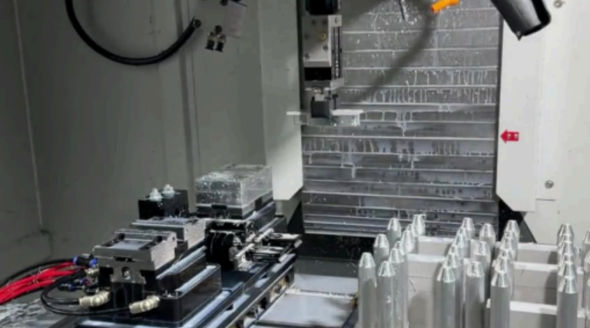

    Step 2 — the integrated QuickFlip180™ station grabs the part by its top hat and flips it exactly 180 degrees, ready for the gripper to re-grab for Op2.

    Step 1: Gripper Loads Raw Stock into Op1 Vise
    The cycle begins with a GimGripper™ spindle gripper (or GimVac™ vacuum gripper) picking up a piece of raw stock from the loading tray. The gripper is held in the spindle just like a tool — no robot arm required. The CNC program commands the spindle to move to the Op1 vise position, the gripper places the stock, and an M-code fires the solenoid to clamp the vise.
    The Op1 AutoVise™ clamps with 900–3,400 lbf of force at 0.0008” repeatability. The gripper returns to the magazine, a cutting tool loads, and Op1 machining begins.
    Step 2: Gripper Grabs the Part, QuickFlip™ Flips It
    After Op1 machining completes, the gripper tool loads back into the spindle. It picks the semi finished part out of the Op1 vise (which opens via M-code) and moves it to the integrated QuickFlip180™ station in the center of the pallet.
    The QuickFlip180™ leverages the remaining “top hat” (uncut stock material) on the part. The gripper places the part into the flip station fingers, releases, and the station pneumatically rotates the part exactly 180 degrees. The gripper then re-grabs the now-flipped part from the other side.

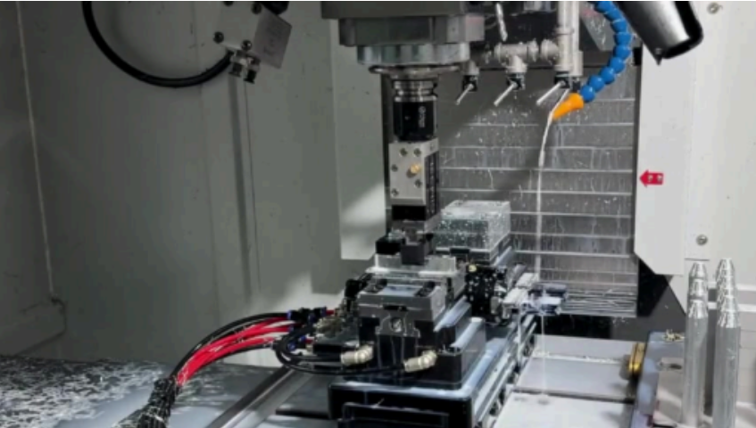

    Step 3: Flipped Part Loaded into Op2 Vise and Machined
    Step 3 — the flipped part is loaded into the Op2 vise soft jaws and machined, producing a 100% complete component.
    The gripper carries the flipped part to the Op2 vise, which features machined soft jaws profiled to the Op1-finished geometry. The part drops into the jaws, an M-code clamps the vise, the gripper returns to the magazine, and Op2 machining begins.
    When Op2 completes, the part is 100% finished — both sides fully machined, ready to ship.

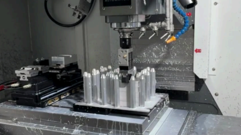

    Step 4: Automated Repeating Production
    Step 4 — the cycle repeats automatically, filling the tray with finished two-op components.
    The gripper unloads the finished part back to the loading tray, picks up the next piece of raw stock, and the entire cycle repeats. This continues unattended until the entire tray is full of finished components.

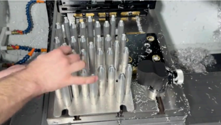

    Step 5: Reload the Stock Tray
    Step 5 — the operator drops in new raw stock. Alignment pins mean no clamping — less than 5 seconds per part.
    When the operator returns, they simply remove the finished parts and drop in new raw stock. Because the loading tray uses alignment pins (no clamping), reloading takes less than 5 seconds per part.
    Technical Specifications
    Specification  Value
    Price  8, 849(100mm)/
    8,749 (75mm)
    Vise Repeatability  0.0008”
    Vise Clamping Force  900 – 3,400 lbf
    Clamping Width Options  75mm or 100mm
    Recommended Air Pressure  100 psi
    Max Air Pressure  130 psi
    Pallet Height  6.2”
    Total Weight  65 lbs
    Air Lines  7 (controlled by 4 solenoids)
    Zero-Point Compatibility  96mm pullstud pattern (5th Axis compatible)
    Technical drawing of the GripFlipGrip5™ showing the 100mm vise configuration with integrated manifold routing.
