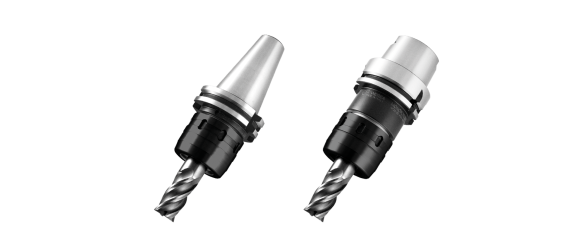

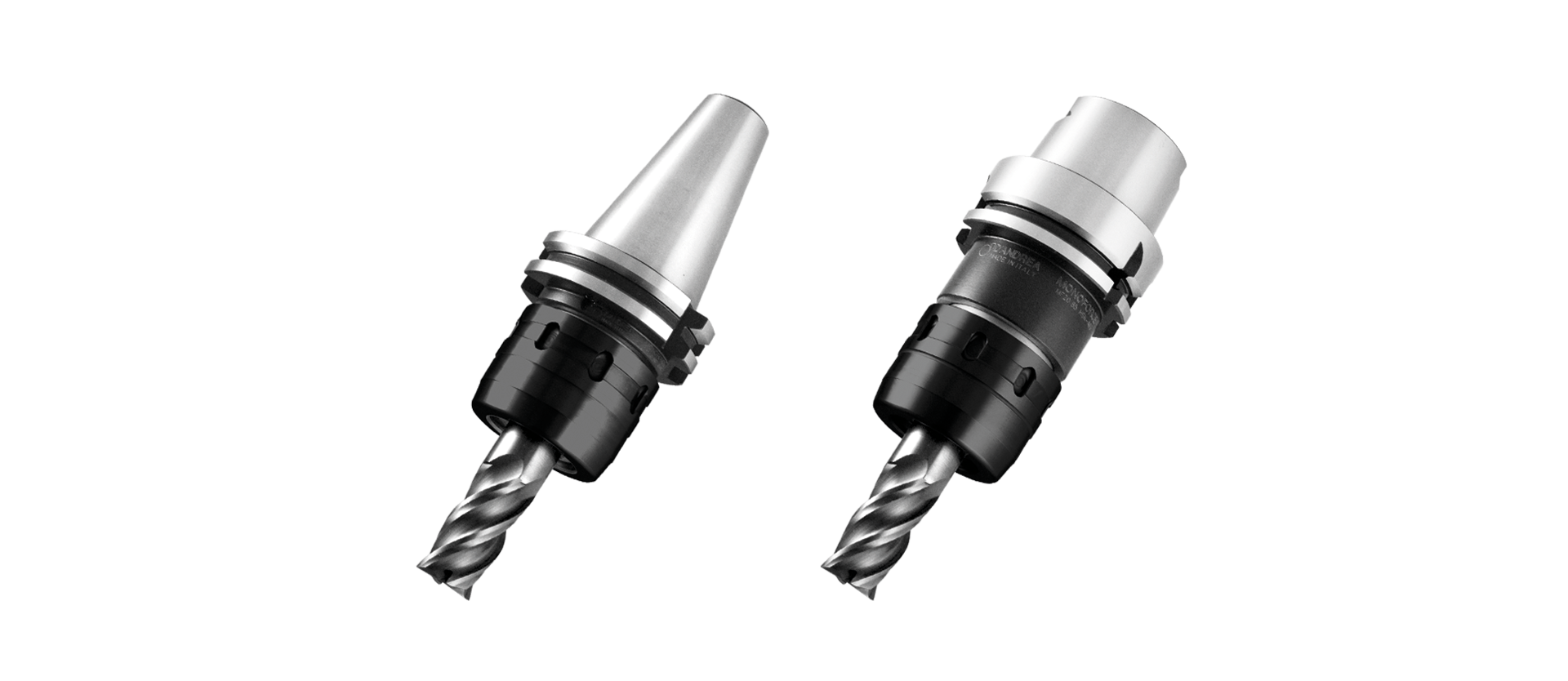

    The ability to maintain one single boring head inventory with interchangeable, modular components is a boon to shop’s that prefer to run leanly and efficiently. D’Andrea’s PSC modular and single-body toolholders feature an ISO 26623-compliant polygonal-tapered spindle interface for exceptional rigidity under demanding cutting conditions helping shops to meet the requirement for their boring, milling, drilling and boring machines, lathes (tapping) and machining centers. The PSC system, offered in modular and single-body options that connect directly to the MHD’ line via dedicated adapters allowing shops to add PSC arbors to their existing MHD’ components and eliminating the need to maintain two separate boring head inventories.
    D’Andrea’s BHT cross bar system (250 mm to 1000 mm) and U-TRONIC heads (360 mm to 1600 mm) cover the full range of large-diameter boring and facing challenges that shops face in aerospace, energy, naval and heavy equipment manufacturing. A single BHT bar body with interchangeable cartridge kits covers roughing and finishing in one setup. Additionally, because they are compatible with the MHD’ system, the bars can be used across multiple machines without dedicated adapters, again, streamlining operations and cutting down on unnecessary inventory. Further, in the same vein, the MONOFORCE high-precision ultra-tight toolholders take it a step further offering high-gripping for demanding milling operations where conventional ER collet holders are insufficient. Ideal for aggressive roughing cycles or high-torque finishing on difficult materials, these toolholders are compatible with a variety of spindles across a mixed machine shop floor. Rounding out the D’Andrea toolholder line are the MONOd’ single-body integral collet chuck line and the THT turning modular toolholders for stationary tool turning operations on large machining centers and horizontal boring mills.
