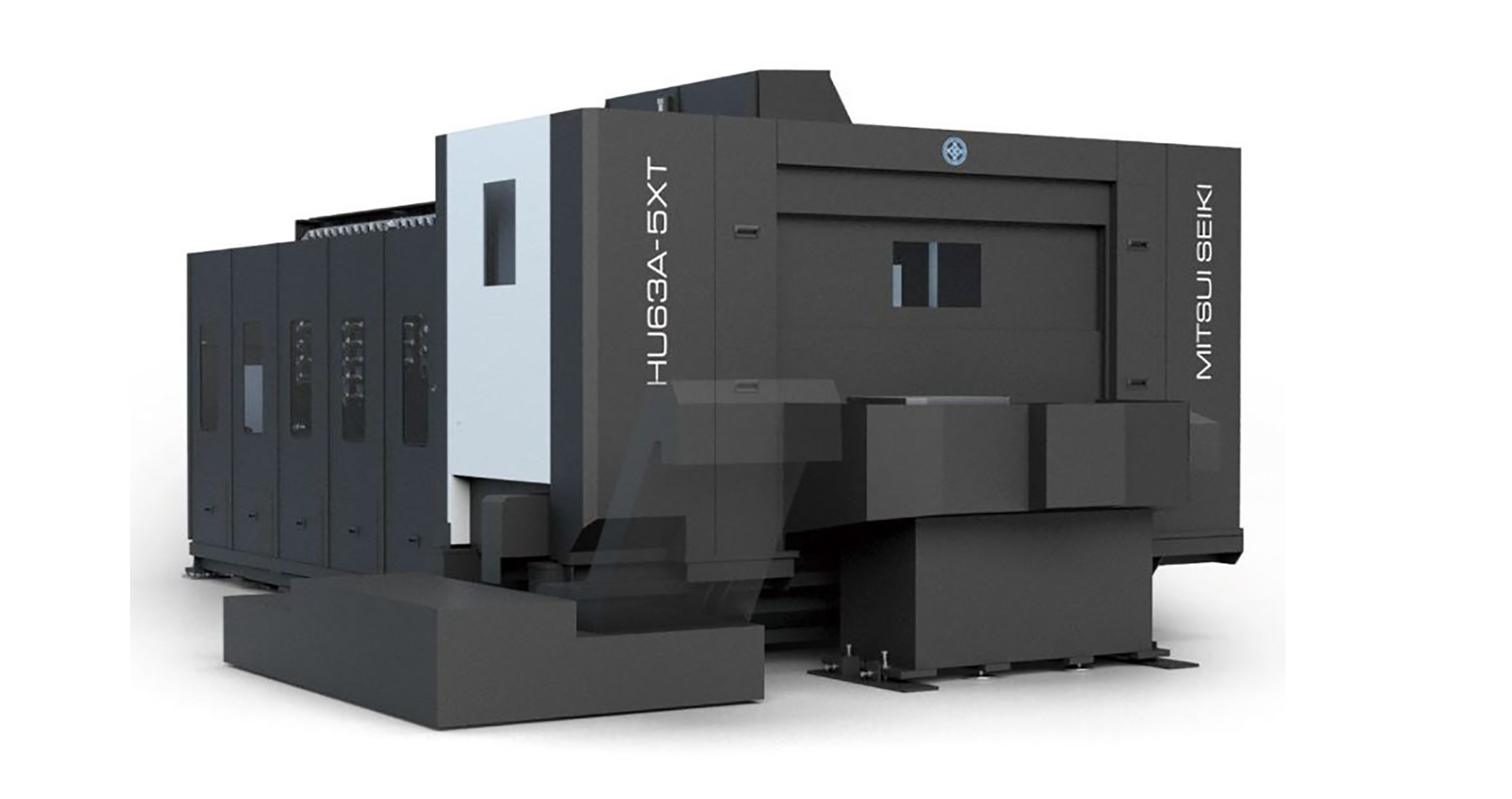

    [Franklin Lakes, NJ – June 18, 2026 ] Mitsui Seiki USA will showcase the high-performance HU63A-5XT 5-axis horizontal machining center in Booth 338700 South Building at IMTS 2026, September 14-19 at McCormick Place (Chicago, Illinois). Designed for next-generation aerospace manufacturing, this high-precision millturn system provides aerospace manufacturers with sophisticated accurate milling and turning capabilities for complete part processing from roughing to finishing in a single setup, virtually ensuring that even the most complex components are machined to spec the first time around. This is especially important to shops manufacturing engine cases/housings where repeatability is essential to reducing the clamping errors that can lead to mismatched components and scrap. The exceptionally accurate HU63A-5XT offers 900 mm X/Y/Z travels with simultaneous 5-axis machining capabilities and features a high-torque spindle delivering up to 1,081 Nm with +/-0.001 mm positioning accuracy.
    Capable of machining hard-to-cut materials such as Titanium, the HU63A-5XT boasts cutting feed rates between 0.1 mm to 10,000 mm/minute in the X, Y and Z axes. Rapid traverse rates in the X axis can reach 12,000 mm/minute while the Y and Z axes travel up to 24,000 mm/minute. When combined with 2,160 degrees/minute for the A axis and 3,600 degrees/minute for the B axis, this millturn delivers unparalleled precision at considerable speeds. When aerospace OEMs have many suppliers to choose from, a machining center such as the HU63A-5XT can give job shops the advantage in landing lucrative contracts. Additionally, this fully automated machining center is equipped with 630 mm square pallets with automatic pallet changer and automatic tool changer as standard.
    This machining center, including two APCs and chip conveyor, measures 5,700 mm x 4,700 mm x 3,450 mm with pallet height ranging from 1,500 mm (APC side) to 1,480 mm (M/C side). Powered by the FANUC Series 501 iS-A controller, which is designed to work with high-speed complex multi-tasking machines such as this, the HU63A-5XT also performs drilling, boring, tapping and reaming operations offering shops a completely automated production operation in one machining powerhouse.
