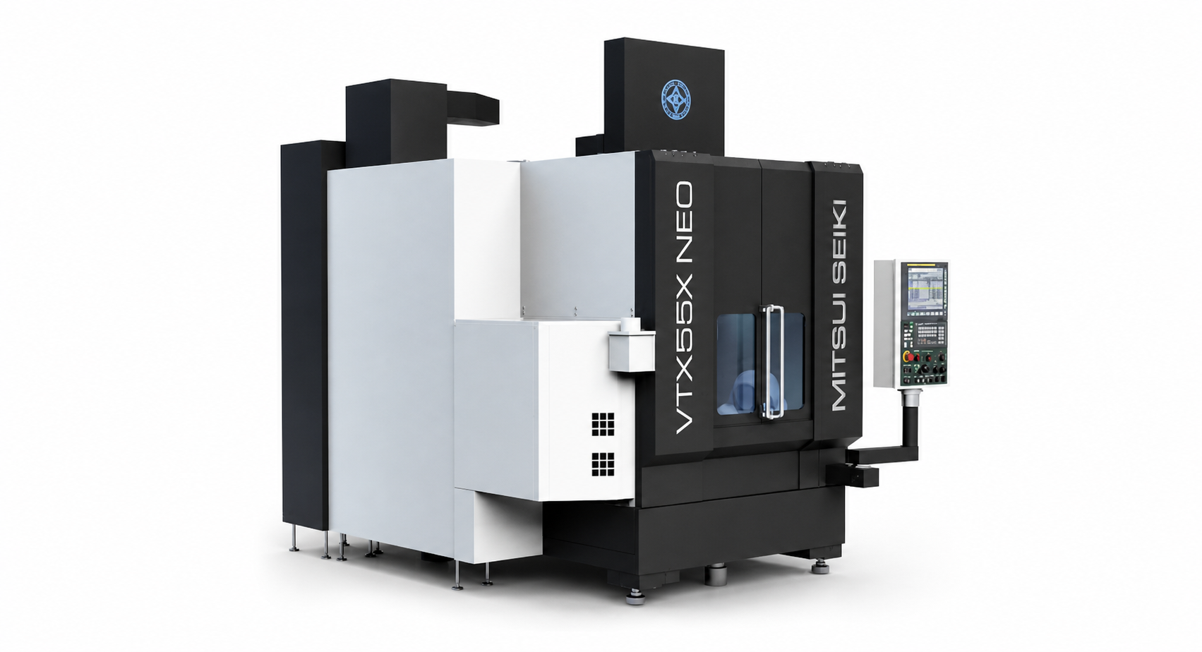

    [Franklin Lakes, NJ – June 24, 2026 ] Mitsui Seiki USA will introduce the Vertex55X
    NEO high-performance vertical machining center with FANUC 31i-B5 Plus control for
    simultaneous precision 5-axis machining applications in Booth 338700 (South Building)
    at IMTS 2026, September 14-19 at McCormick Place (Chicago, Illinois). Designed to
    machine complex blade geometries, difficult-to-cut ceramics, and mold and die
    operations among others, the Vertex55X NEO offers 5-axis configuration with a tilting A-
    axis and full rotary C-axis for more complete machining operations in fewer setups. This
    includes the use of shorter tools for those difficult-to-reach cavities and undercuts, and
    better finishes. Its ultra high-speed spindle capability – up to 30,000 RPM – helps to
    significantly reduce polishing and lead times while at the same time offering advanced
    thermal stability and +/-0.001 mm positioning accuracy. The FANUC 31i-B5 Plus control
    provides AI contour control and high-speed processing. Integrated automation options,
    probing technology and high-speed tool changing capabilities provide mold and die
    manufacturers with the capacity to achieve highly accurate parts to meet even the most
    difficult customer deadlines.
    The Vertex 55X NEO features a table longitudinal stroke (X-axis) of 550 mm, table cross
    stroke (Y-axis) of 600 mm and spindle head vertical stroke (Z-ais) of 500 mm. Roller-
    type linear guide ways offer the high-rigidity necessary to maintain exceptional
    accuracy, precision and repeatability. An absolute linear glass scale indicates the exact
    position of the X/Y/Z axes for accurate repeatability while an absolute rotary Inductosyn
    scale performs the same function for the A and C axes. The machine automatically
    knows its exact position when it’s turned on in both instances. Cutting feed and traverse
    rates range from 0.1-48,000 mm/minute on the X/Y/Z axes to a traverse rate of 40 RPM
    on the A (tilt) axis with a cutting feed of 30 RPM, on the C (rotary) axis. Manufacturers
    are now able to scale up their machining processes from slow and controlled feeds for
    high-precision finishing on those difficult-to reach sections such as cavities and deep
    pockets to the high-speeds required to efficiently rough out large blocks of material for
    precision contouring applications.
    This newly introduced vertical machining center was thoughtfully designed to solve the
    main challenges faced by mold and die manufacturers: deliver complex high-precision
    parts of tough-to-machine materials with the highest degree of accuracy and
    repeatability within demanding lead times. Each Vertex55X NEO is fully customizable to
    meet customer needs.
