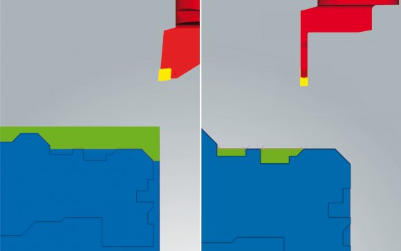

    Programming is simplified within the Mill-Turn module by a new Automatic Contour Feature Splitting capability, enabling hyperMILL® to automatically determine the area to be machined based on the turning contour. The grooving job will automatically recognize if a contour is a groove, making it faster and easier to program certain areas.
