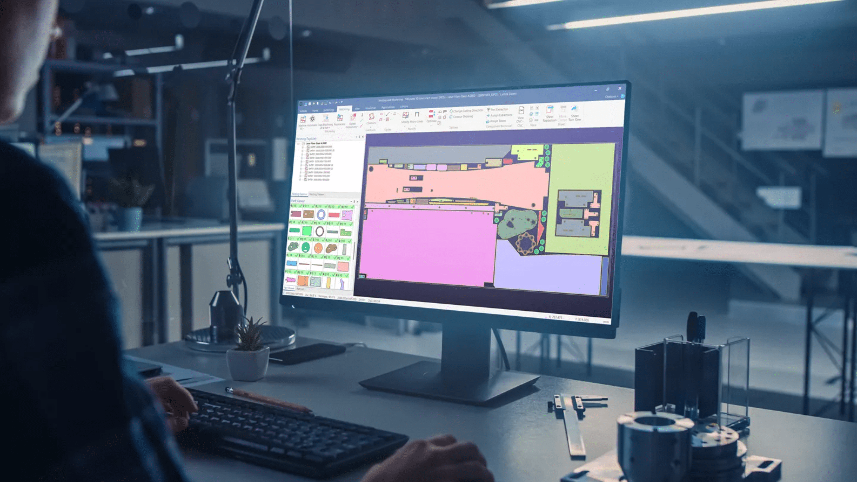

    The latest Nesting by Attribute tool enables users to group and organise parts on sheet metal based on selected criteria, simplifying part identification and improving operator workflow.
    Parts from the same job or production stage can be colour-coded, separated by offset zones or even divided by visible lines, making them easier to identify and remove.
    Adam Ball, Commercial Director at Lantek, explains: “The latest Nesting by Attribute tool is extremely user friendly, helping machine operators quickly identify which parts belong to which job.
    “With today’s high speed modern laser cutting machines, shop floor operators often struggle to sort cut parts quickly enough. Grouping parts from different jobs on a single sheet can sometimes disrupt the production flow if the parts require different post-processing steps. This new feature helps to avoid that, reduce errors and save valuable time.”
    Users can now clearly define nesting priorities using any attributes stored in Lantek Expert or Lantek MES, such as delivery deadlines, follow-up processes, container type, associated job orders or assemblies. During nesting, parts matching the selected properties are prioritised, while others are placed in the remaining spaces.
