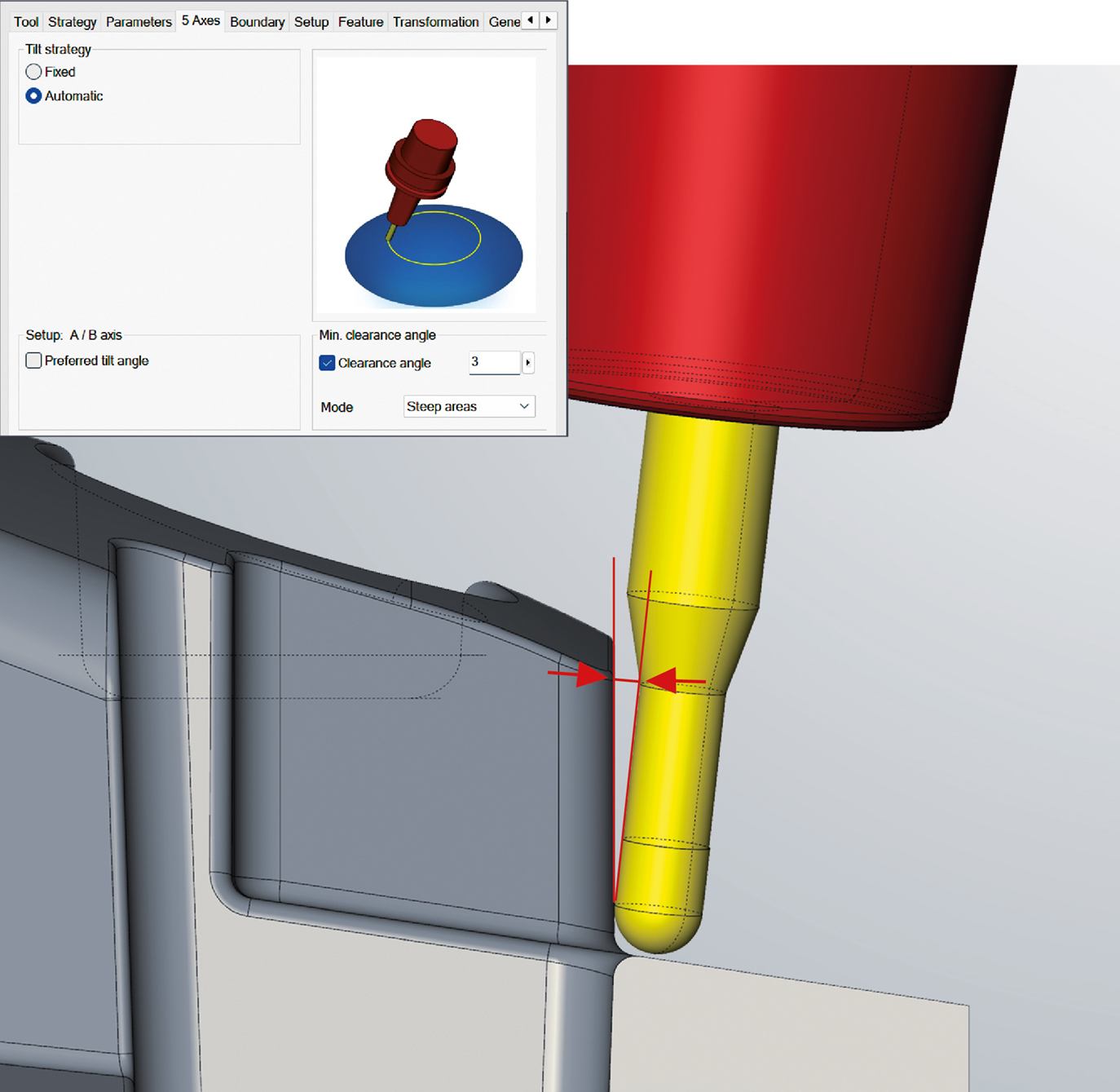

    New and enhanced finishing techniques in hyperMILL® 2026 provide greater control, further increasing machining efficiency and part quality. Rest Machining has been significantly improved to optimize tool paths and create smooth transitions by automatically detecting rest material when taking clearance and feed specifications into account. The 5-axis Rest Machining strategy has been completely redesigned to offer new calculation algorithms for “Z-Level”, “Parallel” and “Normal” machining strategies, ensuring precise and reliable detection and machining of rest material. Determining 5-axis cutter orientation has also been significantly optimized, and collision avoidance has been improved to provide smoother simultaneous movements. And for even more tool control, a new “Minimum Clearance Angle” option ensures that machining is performed with a defined clearance angle.

    A new “Minimum Clearance Angle” option further simplifies reliable 5-axis programming with automatic orientation search and defined clearance angle between the tool shank and part when using hyperMILL® “5-axis Automatic Mode”. Based on a preliminary analysis of the entire toolpath, 5-axis Automatic Mode automatically determines optimal tool positions and efficiently uses indexed and simultaneous movements.
