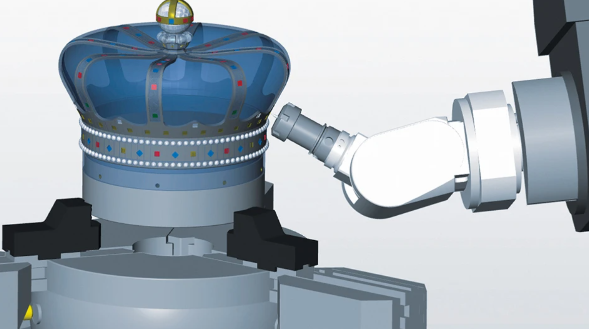

    Programming in hyperMILL® 2026 has also been significantly enhanced with new capabilities for complex machining applications. For the first time in hyperMILL® and hyperMILL® VIRTUAL Machining, programmers can easily program right-angle heads in hyperMILL® TOOL Builder while avoiding costly collisions through detailed simulation and collision tracking.
