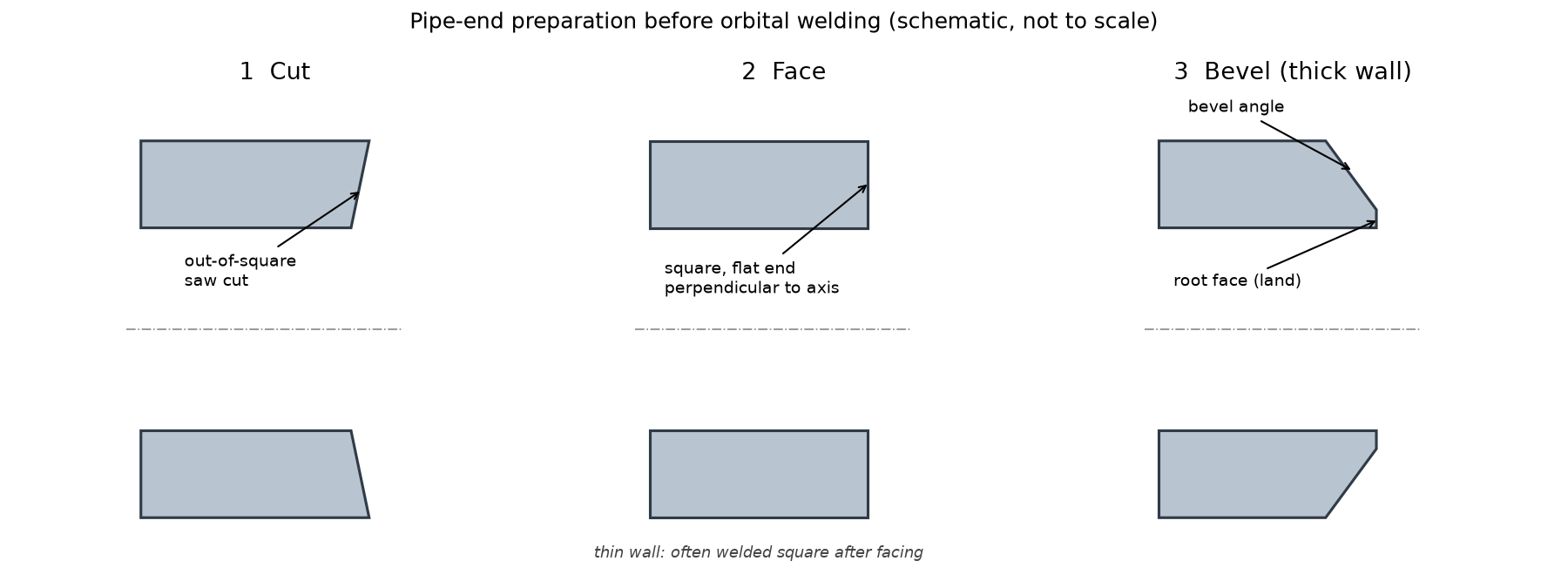

    Three front-end operations on a pipe end before orbital welding — (1) a raw saw cut that may be out of square, (2) the end faced square and flat, perpendicular to the pipe axis, and (3) for thicker walls, a bevel from the outside diameter with a root face (land) at the bore. Thin-wall tube is often welded square after facing. Illustrative schematic, not to scale.

    1. What joint does the welding procedure actually require?
    Start with the approved or intended welding procedure, not the equipment catalogue. The procedure defines the joint design: bevel angle, root face (land), root gap and allowable misalignment. Thin-wall tube is often welded with a square butt prepared by facing alone. Thicker pipe usually needs a bevel, and heavier walls may need a compound or J-profile prepared by a machine that can hold that geometry.
    Buyers should write the joint down as numbers before comparing machines. A request that says only “beveling machine for 8-inch pipe” invites quotations that cannot be compared.
