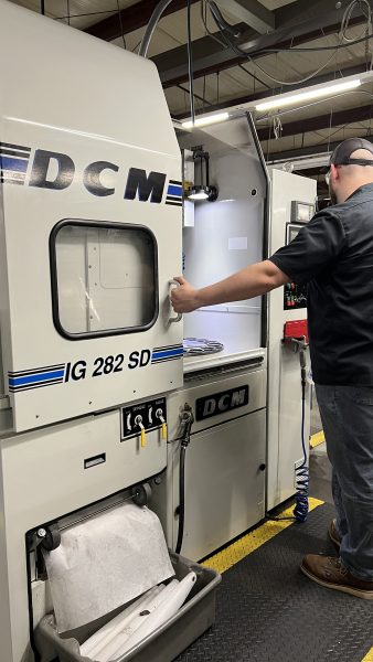

    However, as production requirements increased, the OEM decided to replace a slow, aging reciprocating rotary surface grinder that often needed to be repaired with advanced rotary surface grinders from Winona, MN-based DCM Tech.
    “We were able to achieve the precision and surface finish that we were looking for with the conventional method, but it took significantly longer to grind the same number of parts,” says Desrosiers. “With the [DCM] rotary surface grinder, we knew we could achieve significant time and efficiency gains.”
    Today, rotary surface grinders are designed with much more advanced sensors and controls that automatically maintain very tight tolerances, removing material down to within one ten-thousandth of an inch of the final thickness. Digital technology allows for an interface with easy-to-use touchscreen controls.
    To expedite the grinding and finishing process for the magnet line, the OEM recently upgraded from a conventional rotary surface grinder to a more automated, IG 282 SD grinder from DCM Tech with a 24” variable speed table and 20HP variable speed spindle.
    “We have found that nothing achieves the necessary flatness, height, and parallelism as fast as the DCM Tech rotary surface grinders. The required parallelism is particularly important to prevent vibration at high speeds of rotation,” says Desrosiers.
    The new model includes advanced features that automate the initial contact between the abrasive wheel and the part. With this updated option, advanced sensor technology detects vibration and can automatically fine-tune not only the pressure of the spindle motor but how quickly it moves the wheel down onto the part. When the machine senses the abrasive wheel has contacted the part, it automatically begins the grind cycle.
    Automatic part detection eliminates the need for the operator to do time consuming, error-prone ‘manual touch offs,’ where they would manually feed the grinding machine until it just touches the surface of the part before backing off and restarting it.
    “The DCM Tech grinder simplifies the skillset needed and makes training a new operator a lot easier,” says MAGSEAL Manufacturing Engineering Technician Westgate.
    One of the reasons advanced rotary surface grinders are much faster than conventional reciprocating grinders is because the units can get much closer to the required dimensions before any finishing steps. In some cases, secondary steps can even be eliminated.
    According to Desrosiers, the increased automation and ease of use has helped to dramatically improve magnet production.
    “We went from an average of three and a half minutes per piece to just under one minute per piece. We increased manufacturing capacity with reduced setup, loading/unloading, and cycle time,” says Desrosiers, adding that by reducing or eliminating the need for subsequent finishing processes, the company was able to achieve ROI in about three months.
    MAGSEAL also appreciated the rotary surface grinder’s enhanced safety and cleanliness features.
    Automated grinders contribute to a cleaner shop environment because the grinding is accomplished inside an enclosed shroud that contains the debris and prevents it from entering the work area. The shroud, which is a sliding door with a built-in window for viewing the process, encloses the grinding area. This has the added benefit of reducing the noise produced by the machine.
    In addition to a shroud, grinders like the DCM IG series provide an integral air mist collection system that draws particulate matter from the air and moves it away from the operator to enhance the cleanliness and safety of the work environment.
    “For us, safety is paramount. The advanced rotary surface grinder is a fully enclosed machine with door interlocks. This configuration is significantly safer and cleaner than a conventional service grinder,” says Desrosiers.
    He notes that MAGSEAL has already ordered another advanced rotary surface grinder to replace an aging reciprocal grinder used for the initial “rough” grind of the magnets.
