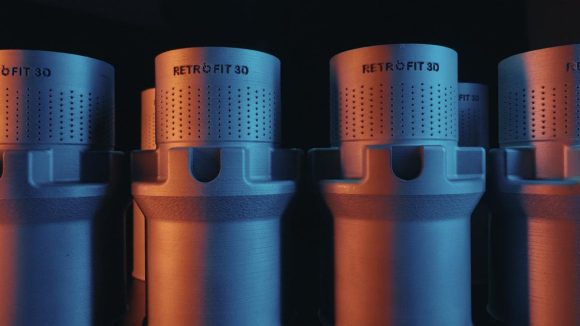

    The new project was based on the very same choke valve, a high-pressure flow-control device used in water-injection wells to prevent issues with erosion, noise, and vibration. The component is a 3D-printed upgrade to a part originally manufactured through conventional means, such as machining and brazing. The AM redesign enhances the effectiveness of IMI Critical’s proprietary Drag technology, which manages destructive fluid flow velocities through control valves. The parts were manufactured in accordance to the highest criticality—AMSL Level 3 per API20S—standards set by the American Petroleum Institute (API).

    The existing Velo3D print file from the 2021 project, which includes the entire instruction set for 3D printing it, was pulled from IMI Critical’s PLM system, securely sent to six manufacturing sites across three continents—four in the U.S., one in Asia and one in Europe.
    The CMs involved were Stratasys Direct Manufacturing (Austin, TX), Duncan Machine Products (Duncan, Oklahoma), Knust-Godwin (Katy, Texas), Avaco (South Korea), and Schoeller Bleckmann Oilfield Equipment (SBO, Austria). The sixth print run was performed at Velo3D headquarters in California.
    Tight control every step of the way
    Here’s how the project was carried out:
    ·      At each CM site, the Velo3D Sapphire system went through a series of calibration checks to ensure predictable and consistent print outcomes.
    ·      The locked, “Golden Print File” was loaded into each Velo3D Sapphire system; its set of laser instructions could not be altered at the CM site. This was the original Print file, with no alterations, from 2021, that was created using feature-based parameters assigned by Flow, Velo3D’s print-preparation software.
    ·      3D Printing: Each build contained two parts and was printed on-site. Both the calibration processes and print execution quality are monitored by Assure, which is embedded in every Sapphire system.
    ·      Build Reports: are automatically generated by Assure, which collects data from the 800+ sensors that monitor the build, ensuring that each build at every CM’s machine was executed consistently, and within the process-control limits. In the case of IMI/CCI’s choke valve, the data collected from Assure conforms to requirements prescribed by API20S, and integrated seamlessly within the OEM’s quality system.
    ·      After-build de-powdering: Excess powder was removed from the parts in each build.
    ·      Post-Processing: The parts were then stress relieved and removed from the build plate. Additional heat treatments and machining were conducted at each location.
    ·      Quality Control: includes dimensional inspection, mechanical testing, and flow testing of each valve.
    ·      Dimensional inspection of the final part.
    The results are in
    Following the completion of the steps outlined above, collation of data for the 12 printed parts, two parts from each of the six production locations, has now been completed with these results: Mechanical testing and flow testing—along with destructive and non-destructive evaluation of the material coupons—demonstrates that all of the parts, both metallurgically and functionally, met IMI’s design and performance specifications.
