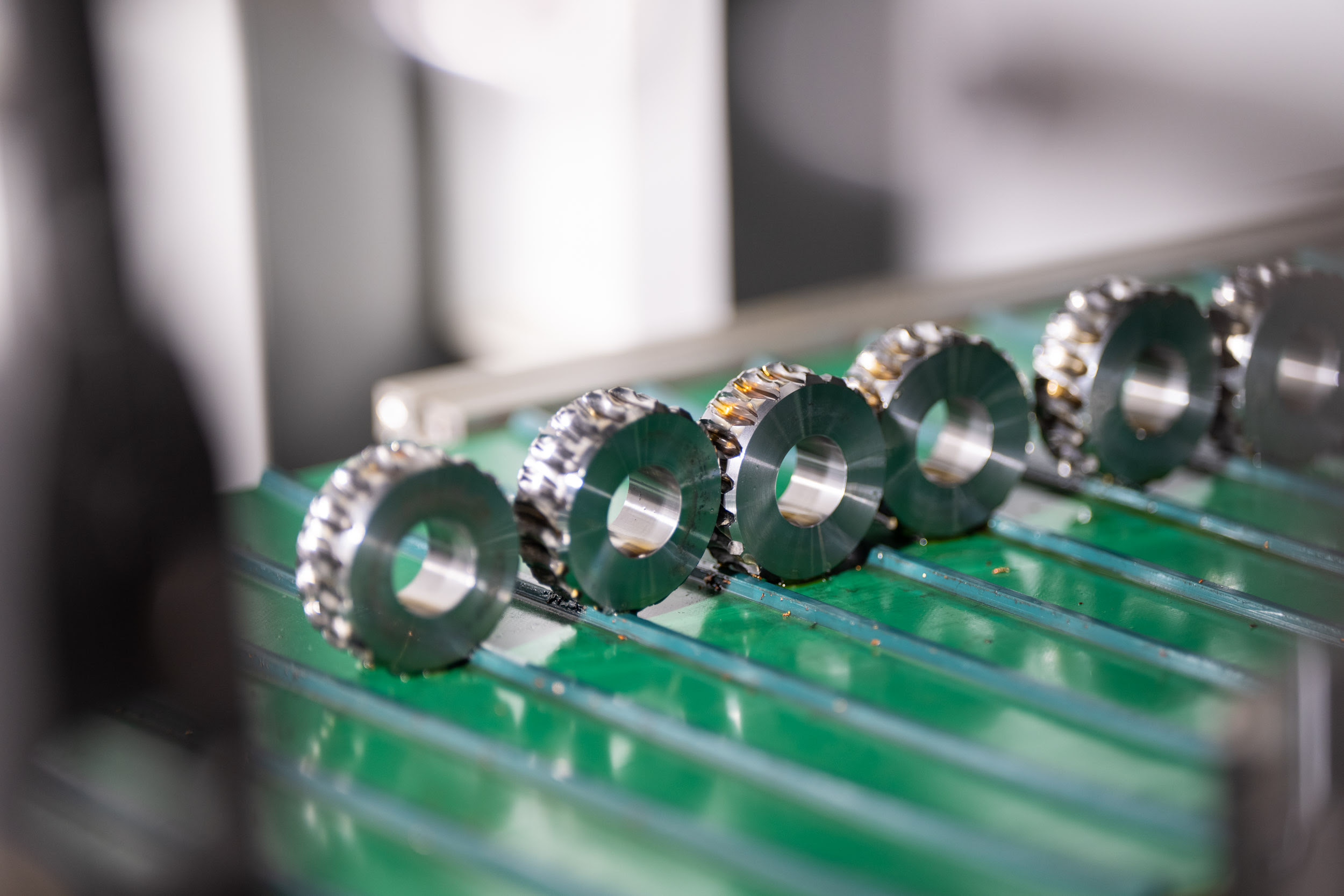

    The machine has made us so much more productive. There are jobs that used to take a week, and now we are knocking them out in two days or less. It’s been a game-changer for us. We’ve done spurs, helicals, worm gears, and now we’re doing worms, so basically everything it’s made to do, we’ve run through it. We had a recent worm gear job that we knocked out in about a week and a half, and it was probably a 1000-piece run and that stuff was super hard. Previously it would have taken us over a month on the slower Barber-Colman. So again, it’s been a game changer. Everything that we’ve thrown at it, it’s been able to do.

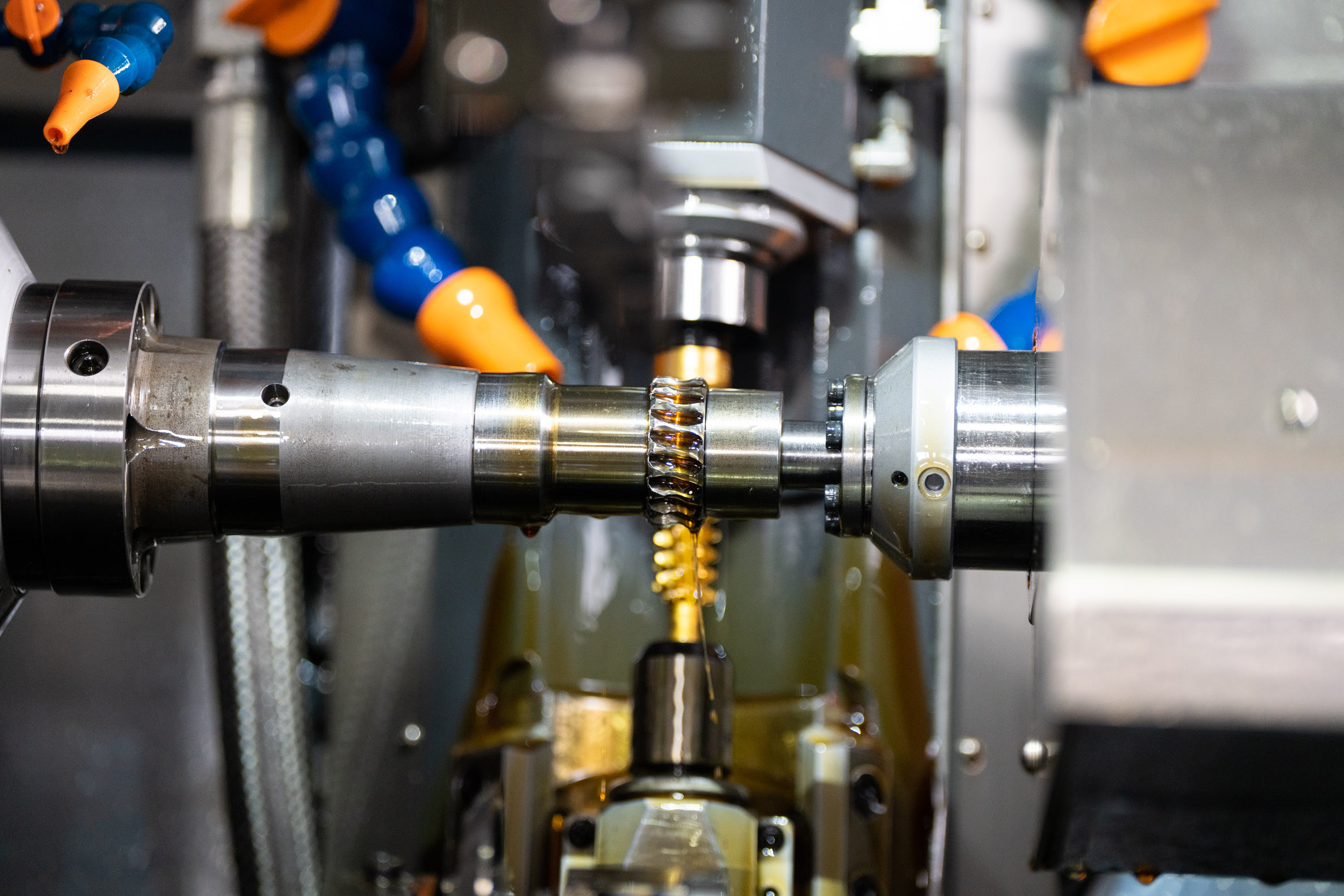

    We ran seven jobs back to back on the same arbor and all we had to do was go up to the control and change the number of teeth; we never had to change the work arbor, never had to change the hob, and because of the CNC control and the accuracy of the machine, we just put in exactly what size we wanted, and we ran seven jobs and cut them all in a matter of hours. As opposed to if we would’ve had to stop, change all of the gears, lead gears, differential gears, all the different stuff on the Barber-Colmans; it would just take so much longer in setup time. With the accuracy of the machine we were able to check them immediately in our CNC gear checker and everything was spot on, right where it needed to be.

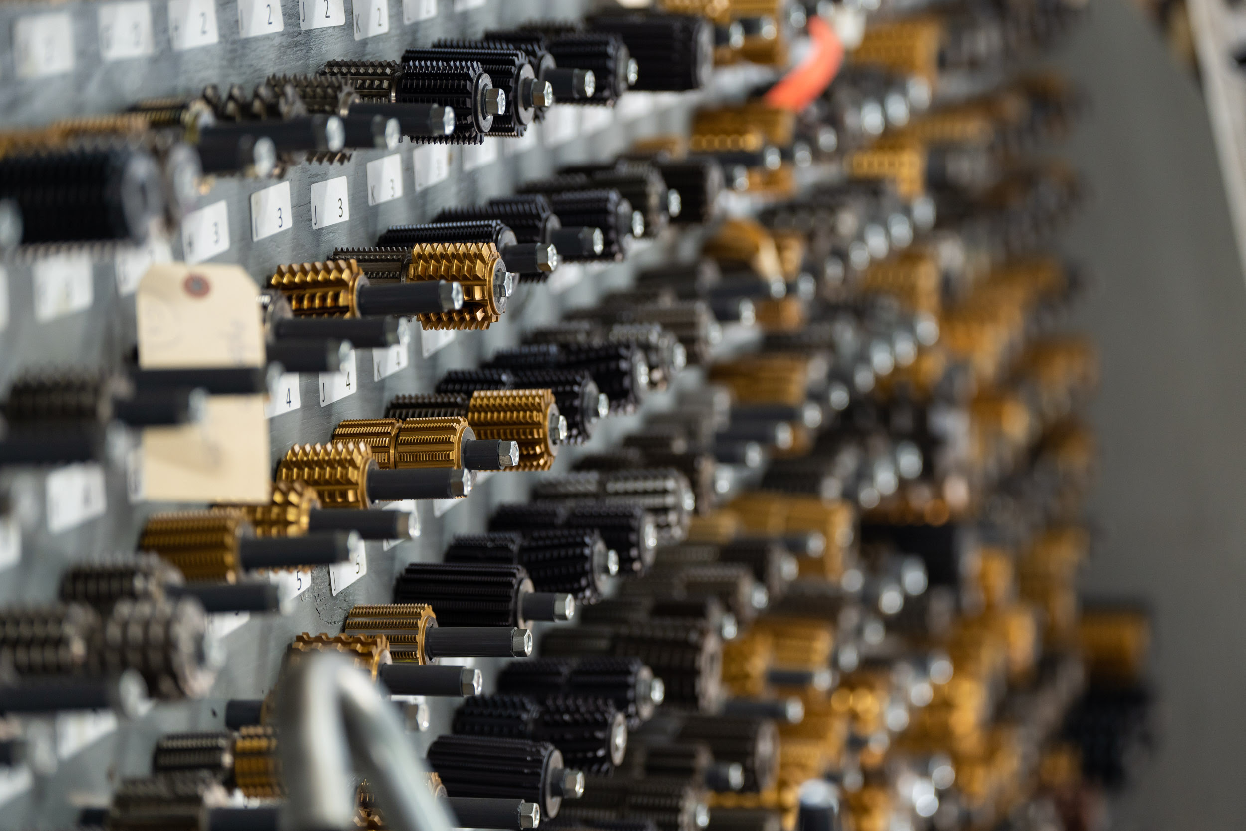

    Our top three are the capability of the machine, the repeatability of the machine, and the accuracy of the machine. With the Hera, we’ve been able to save so much time because the machine automatically goes back to the settings where we were successful. We’re using the same hob, the same tooling, and our setup times have been significantly cut. We also appreciate the rigidity of the machine. On tough-to-cut parts, we used to run a few hundred parts and the hob would be done; we would have to take it out, sharpen it, and recoat it. With the Hera we’re cutting over 1000 parts because it’s just that much more of a rock solid, rigid machine.

    In the Barber-Colman we were limited by a 600 RPM hob spindle. In the Hera, we’ve got 6000 RPMs, so we’re not limited at all and it really becomes a limitation of how fast the tool can run. We were running a high speed steel hob that was coated so we were able to ramp that up to 1000 RPM without a problem. We even now have the ability to utilize carbide hobs which we have done on some jobs, and we can take that 1000 RPM up to 2000 or 3000 RPMs. So our cutting cycle time improved dramatically, 2x to 3x faster. But even more importantly, there’s a deburring disk in the Hera 90. The deburring disk comes up and deburrs each part so all we need to do is just a very light brush when the part comes out of the machine, which saves a tremendous amount of deburring and handling time. So it’s not just a cycle time and accuracy improvement, it’s also a handling and deburring improvement.

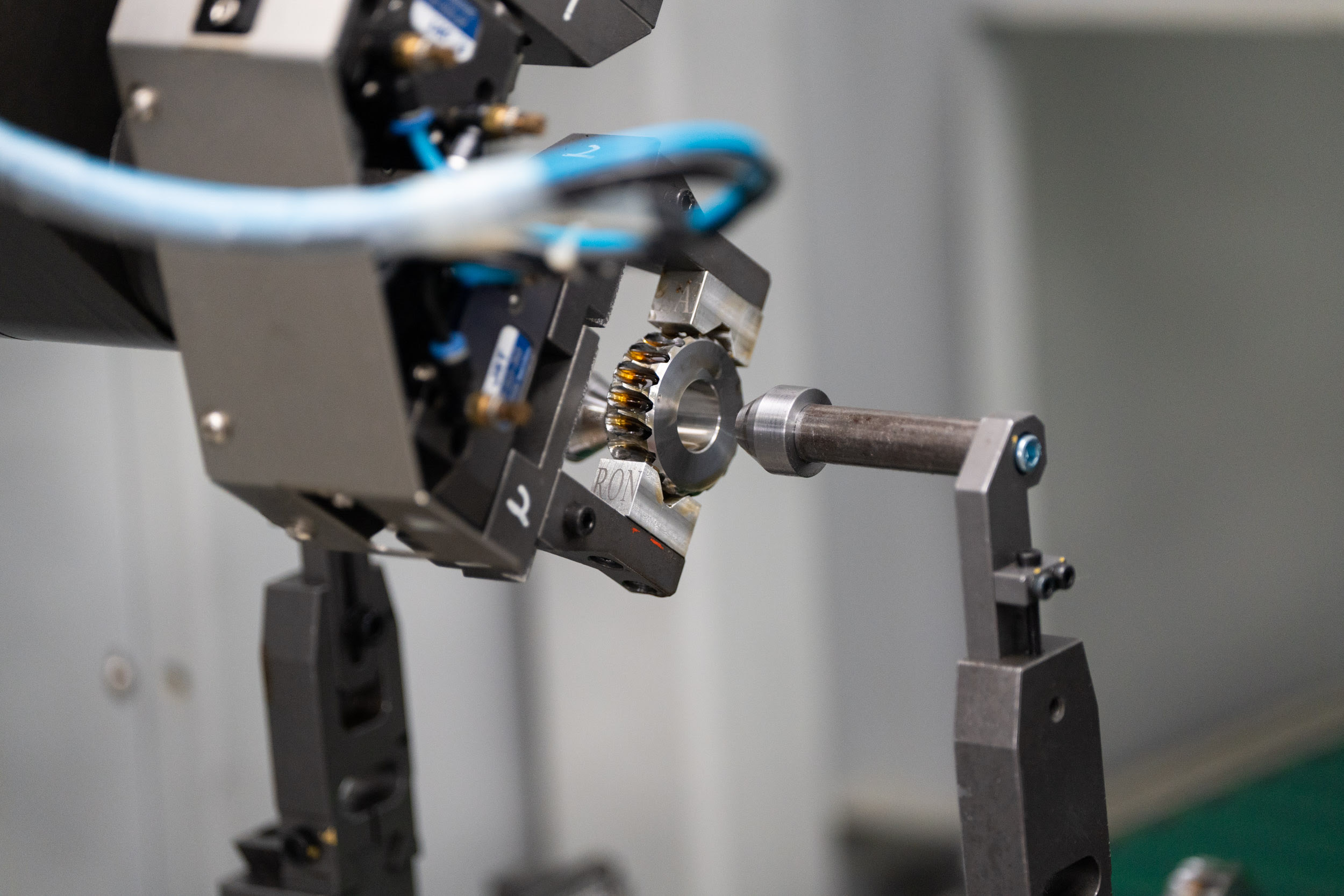

    Before the Hera 90 we would run higher volume jobs on more manual equipment, putting a lot of strain and load on the operators; you may have a short cycle of 3-4 minutes, and then you need to spend 2 minutes changing the part. The Hera 90 brought us automation. Since we were able to make the tooling in-house with our own machine shop, we were up and running immediately. The machine is loading and unloading faster than any operator could do manually, and it takes all that load off of the operators, so that was really good to see. We’ve improved our efficiency, we’ve improved our quality, and we’re cutting parts faster. Everything from that standpoint worked out really well and was a no-brainer.
