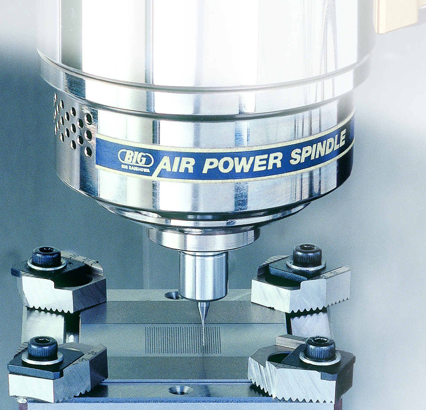

    Beyond the risks (and subsequent costs), high-speed machining requires a higher upfront investment in the machine itself. Spindle speed specifications are one thing, but you’ll also want to make sure your machine tool brand of choice has a reputation for quality and durability. Look for machines that feature direct-drive motors, air-driven spindle systems and magnetic bearings—all of which improve the stability, speed and response times needed in high-speed machining.
