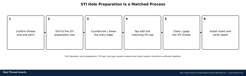

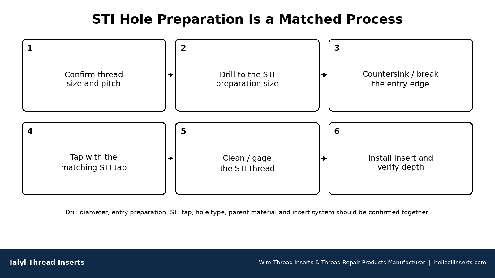

    A simple shop-floor selection sequence
    1. Identify the original thread standard, nominal diameter and pitch.
    2. Confirm whether the receiving hole is through or blind and measure usable depth.
    3. Identify the parent material and select an STI tap style that suits the hole and chip flow.
    4. Use the current drill recommendation for the specific insert/tap system.
    5. Plan drilling and tapping depth before machining a blind hole.
    6. After tapping, clean the hole and use the appropriate STI gage where controlled fit is required.
    7. Install the insert and verify installation depth and screw engagement.
