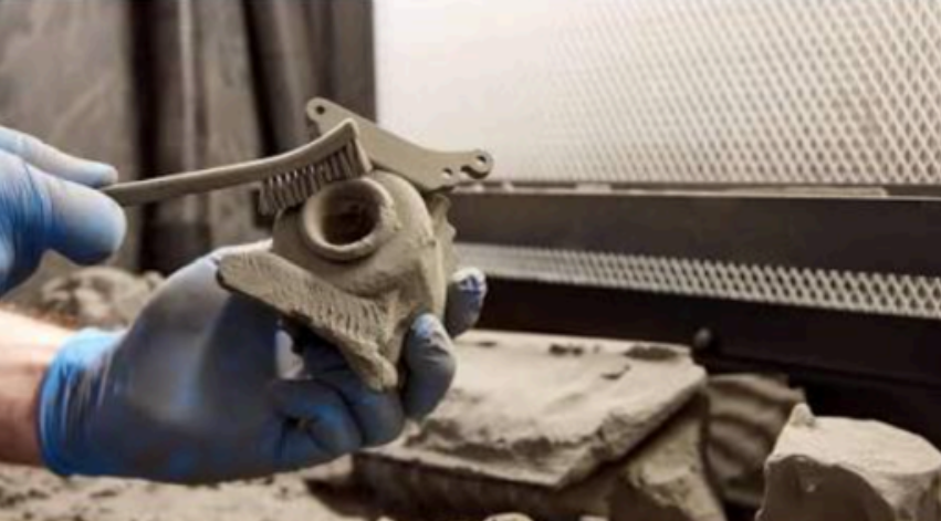

    When a build finishes, the parts are encased in a dense “cake” of unsintered nylon powder. After the initial breakout, operators must spend hours standing at a manual blast cabinet, individually blasting each part to remove the stubborn powder clinging to the surface and internal cavities. This manual SLS depowdering is tedious, dusty, and incredibly labor-intensive.

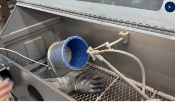

    The TumbleBlast is a drop-in automatic tumble basket designed to sit inside any standard manual blast cabinet. Priced at just $879, it effectively turns a cheap manual cabinet into an automated media blasting 3D prints station.
    How It Works for 3D Printed Parts

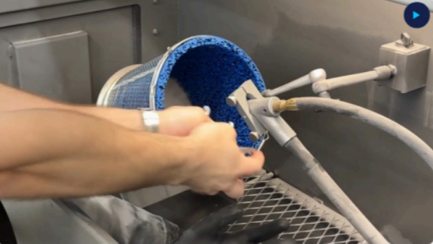

    The workflow is remarkably simple. Instead of holding parts one by one, the operator loads a batch of raw SLS or MJF parts into the stainless steel mesh basket. They then use the included articulating blaster mount to aim the cabinet’s existing blast gun directly into the basket opening.
    Loading a batch of SLS-printed parts into the TumbleBlast basket for hands-free processing.
    When turned on, the basket slowly rotates, tumbling the parts over each other while the blast gun continuously hits them with glass beads or other non-abrasive media. This tumbling action ensures that every surface of every part is exposed to the blast stream.
    After 10 to 15 minutes, the operator returns to find a batch of perfectly clean parts with a uniform, satin MJF surface finishing. The operator was free to pack the next build, clean the

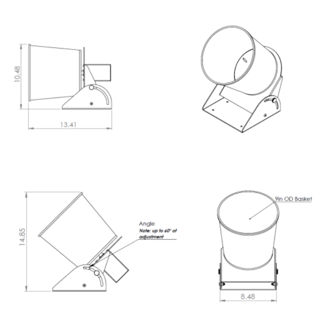

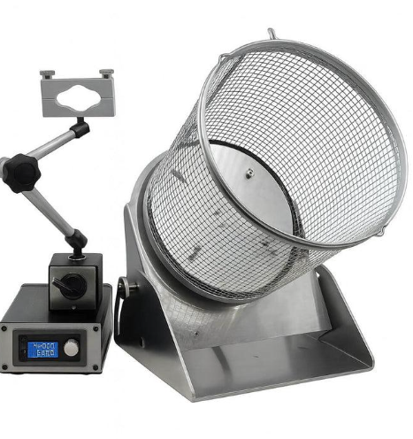

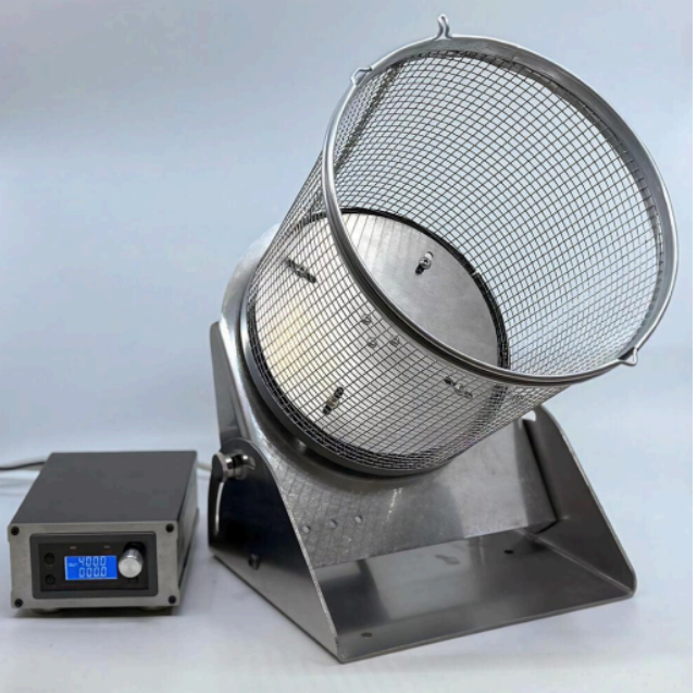

    The Standard TumbleBlast™ features a digitally-controlled stepper motor and adjustable basket angle for optimal media distribution.
    Specifications at a Glance
    Feature  Standard TumbleBlast™
    Price  $879
    Best For  Bead-blasting & non-abrasive media
    Max Load  10 lbs
    Ideal Use Cases  SLS prints, MJF prints, machined parts, deburring
    Cabinet Compatibility  Most free-standing and tabletop cabinets
    Motor  Nema 17 stepper with digital speed control
    Weight  15 lbs
