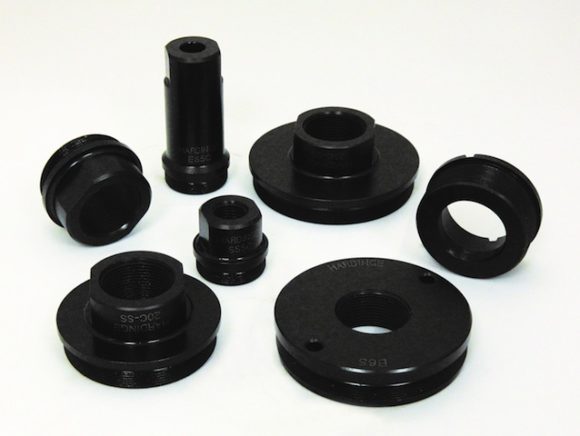

    The most obvious kind of part family is made up of items that share a name and geometry – 8-32 pan-head screws in different lengths, or a series of standoffs that come in different lengths, perhaps with different features (through hole or internal thread).
    From a machining perspective, however, other characteristics can also define a family. Consider parts that you can
    • hold in the same fixture
    • run with variations on the same program
    • make using the same type of operations
    • cut with the same set of tools.
    Sometimes it’s hard to see these commonalities, but once you do, you can use them to boost production by reducing setup and changeover time, minimize programming effort, or improve other aspects of your process.

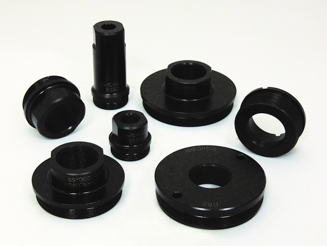

    A family of parts. Photo courtesy of Hardinge.
