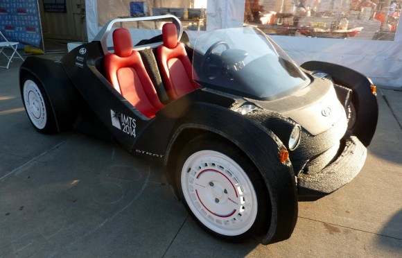

    This irresistible attraction was a 3-D printed vehicle made by Local Motors, and interest at the New York Hall of Science in Flushing Meadows-Corona Park in Queens was intense. Bystanders crowded around, closely inspecting the car’s structure, which combines the body and chassis in a single unit and is made entirely from a composite, acrylonitrile butadiene styrene, reinforced with carbon fiber. Commonly called A.B.S., it is the same thermoplastic used to make Lego bricks.

    After months of preparation, which involved testing the viability of large-scale 3-D printing, the Strati came to life this month at the International Manufacturing Technology Show in Chicago. All the printing, done on a printer about the size of a shipping container, was completed on-site in Chicago in 44 hours, with a team from Local Motors finishing the assembly by sanding and shaping the body for a better finish and by fitting the mechanical components to the body. The entire process took about four days, Mr. Rogers said. (Assembly video.)
    The car consists of fewer than 50 parts, the company says, including a 45-kilowatt electric motor and a transmission donated by Renault, along with headlights, taillights, wheels and a steering column bought from other manufacturers.

    Large-scale 3-D printing is a relatively new process, but has the potential to be used in an array of industries, including aerospace, according to James Earle, an engineer at Local Motors. Mr. Earle says the printing process is similar to the operation of a hot-glue gun, beginning with solid thermoplastic pellets that are heated and then extruded in liquid form through a nozzle. The nozzle, moving like the head of a computer printer, adds layer after layer of material in thin strips until the object is complete, resulting in something of a corduroy surface texture.

    In a brief low-speed ride on paved paths in the park, the 2,200-pound Strati hummed quietly and handled bumps surprisingly well. When asked what would happen in a crash, though, Mr. Earle, driving the two-seat car, said it would be like a rock slamming against a brick wall.
    The thermoplastic used on the Strati is not stronger than a metal counterpart per weight, Mr. Earle said. “These composites allow us to do a lot of cool stuff where you can get a high-strength plastic that is much lighter than its metal counterpart could be. We’re not there yet, because this technology is really at its birth.”
