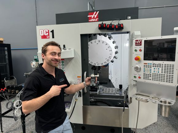

    Michael Gimbel holding a CNC mill robot gripper

    Noah: Explain how the spindle gripper works.
    Michael: A spindle gripper goes into the automatic tool changer of your machine, loading into the spindle like a tool. This whole sub-assembly goes into your spindle, and when air is turned on, it closes. This allows it, like a robot gripper, to grab a component. Parts are loaded onto the table in a tray on a grid. The gripper comes down, clamps on a part in the grid, lifts up, and drops it off in an automated vise.
    It does this without an external robot. We invented a new method for machines without through spindle air coolant, which is a huge portion of the market. We soft launched it and sold quite a few. We started with a couple big customers who liked what we were doing. We’ve exponentially grown the automation business from there, adding air vises, a conveyor loading system, and modules. Lately, we’ve focused on delivering total automation solutions.
    Noah: You came up with this because you were short on people?
    Michael: When I invented it, there were four of us, but I was the only one who could run a CNC machine. For production orders, I had to either turn them away or do them myself. It was built out of necessity – I needed a way to run parts. We used it for years before turning it into a product, which is now our primary business.
    Noah: It’s a gripper that hooks onto the spindle. How is it automation? The part still has to get in the machine. Don’t you need a robot, person, or loading system?
    Michael: We put at least one piece of automated work holding, like an air vise, onto the table, and have a fully adjustable part tray grid. You need room for a vise and a tray, and one of these grippers goes in the spindle. You set the vise, and using our program generator or automated templates, you upload your program. It’s as easy to program a run of 20 as it is for your setup guy to run one part.
    When you hit go, the generated program moves the table so the tray of parts is perfectly under the gripper. The gripper comes down, clamps a part, lifts up, centers over the vise, deposits the part, and the machining cycle runs. For a simple one-operation pallet system, we put that part back and move to the next one. The machine keeps going until the tray is empty. We’ve taken it further with a system using a second vise for the second operation and an integrated flip station for a third operation in the same cycle.
