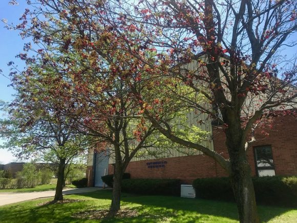

    Apple trees in front of Graff-Pinkert

    This year I’m spraying the apple trees on the Graff-Pinkert property. They have a fungus on the bark, and last year we lost the entire crop. This year I hope to see a big crop of tasty, red Jonathan apples in September. Is it an economic judgment to spray? Hardly. It is all about the fun of picking and eating the fruit.
