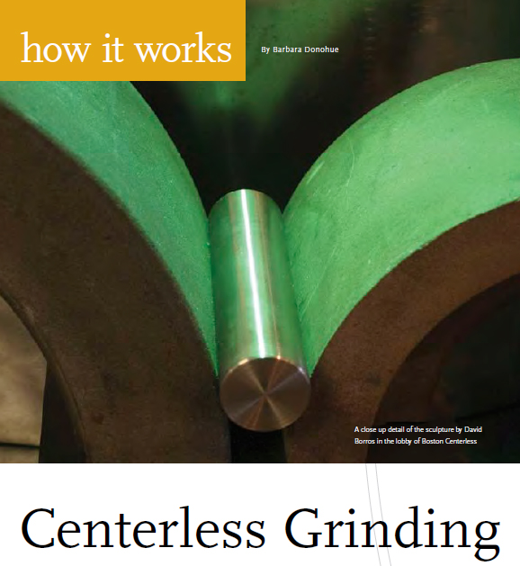

    In a way, grinding is like any other machining process. It removes metal. But instead of having one, or two, or a few cutting edges, like a lathe cutting tool, a drill or an end mill, a grinding wheel has thousands of cutting edges; each grain of abrasive acts as a cutting tool.
    Centerless grinding, as the name implies, is a process that grinds the surface of a turned part or round bar of material, without the need to support the work piece on centers.

    For grinding round bar stock, a “through grinding” process is used. A bar of material, typically twelve feet long, feeds into the grinding machine between a grinding wheel and a regulating wheel. A carbide-tipped strip of steel, the work blade, supports the bar and holds it at the correct height, above the centerline of the grinding and regulating wheels. This is critical to the roundness and diameter tolerances of the bar. Both wheels rotate. The regulating wheel is slanted up a little from the horizontal. As it turns, it pulls the bar past the grinding wheel, so no external feeding mechanism is required.
    Each abrasive grain on the surface of the grinding wheel takes a little bite of material every time it passes the bar being ground. This produces a lot of heat, of course, so the grinding area is flooded with a generous flow of coolant. The regulating wheel does not remove any material. It just presses the work piece against the grinding wheel and controls how fast the bar rotates and how fast it moves past the grinding wheel.

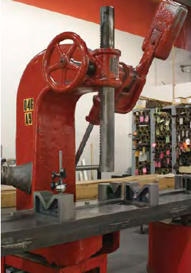

    This Arbor press is a manual bar straightener, shown here with the handle rotated back.
    To produce straightened, ground bar, the first step is straightening. Small diameter bar is run through an automatic straightening machine, which passes the bar between two rollers. This may not straighten the bar completely, so after the operator measures the bar, he sometimes needs to straighten it further using a manual arbor press. Larger diameter bar that does not fit through the automatic straightener is straightened by hand. The operator uses a dial indicator to find where the bar is curved or bent and then applies pressure with a hydraulic ram to bring it in line.
    Straightness is measured in deviation over a certain length. A typical straightness tolerance for straightened, ground stock might be 0.005” per foot. The straightened bar then goes through a series of passes on the centerless grinders. Several passes may be needed. If stock is removed too aggressively, the bar can go out of round.

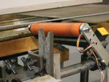

    An automatic unloader machine unloads the finished rods; as it rises, the orange roller lifts the metal rod off the brackets until it rolls clear into a collection container.
