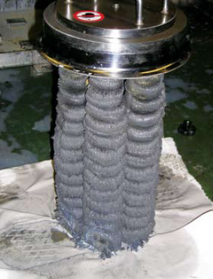

    Filter, clean and recycle
    You can use a movable filtration unit, which wheels up to the machine, such as the portable filtration cart available from Knoll America. This unit incorporates a bag filter and/or a magnetic filter, and can remove particulates down to 5 microns (about 0.00002”). It sells for about $7,500, according to Cruey. This type of unit draws fluid from the machine sump, filters it how it works
    and returns it to the sump. Portable tramp oil removers are also available.
    To clean the fluid even more thoroughly, you may want to invest in a self-contained recycling unit. These remove tramp oil and thoroughly filter the fluid. Such a unit might cost $100,000, Friedman said. “The important thing is: the fluid is expensive to use and expensive to dispose of, so buying a quality recycling system [can] save money in the long run.”
    You need to remove the fluid from the machine, said Friedman, take it somewhere and clean it. At the same time, you can clean the sump. “The right way to do this is on a scheduled basis,” Friedman said, ideally once a month. Vacuum out the coolant from the machine tool sump and take it to your recycling system. Then you can immediately refill the sump with fresh or recycled fluid and start making parts again.
