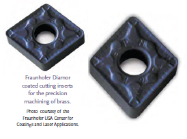

    One impressive new coating comes from the Fraunhofer Center for Coatings and Laser Applications (in partnership with Michigan State University), East Lansing, MI. “Diamor” is a super-hard, yet low-friction, amorphous carbon coating. MSU mechanical engineering associate professor Patrick Kwon explained that such a coating would be ideal for hard machining of non-ferrous metals. However, he cautioned, a carbon coating like that should not be used with ferrous metals, as the carbon has a strong affinity for iron and would “dissolve” in the chips and work piece material.
    So many different tools and coatings are out there that the tricky part of doing the job can be to figure out which combination of tool, coating and machining parameters will work best. The wrong tool under the wrong conditions will fail. Your tooling suppliers know what’s available and what will work best with your job. Based on what material you are cutting and the job’s requirements for surface finish, etc., a supplier can recommend a tool and specify speed, feed and whether you should run it dry or wet.

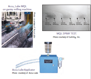

    If you can’t run completely dry, you may still be able to run without resorting to flood coolant. Minimum quantity lubrication (MQL) systems apply a very light spray of an oil/air mixture to the cutting area. This lubricates the tool as it cuts. The heat of machining burns off or evaporates much of the oil, leaving a nearly dry part and nearly dry chips. In MQL, also called “near-dry,” a nozzle or aerosol generator disperses the oil into fine droplets in air, producing an aerosol or mist. This oil/air mixture is delivered to the work either externally or internally through the spindle and via coolant holes in the tool. –Program codes control coolant delivery. The amount of oil varies, depending on the MQL system used and the machining process it is lubricating. A machining center might use 20 to 50 ml (0.67 to 1.67 ounces) per hour.
    The oil used for MQL is often vegetable based. “A good vegetable oil does the job,” said Wally Boelkins, president, Unist, Inc., Grand Rapids, MI, a longtime MQL supplier. Unist uses a refined version of rape seed (canola) oil. It has a high fl ash point, around 400 to 450 degrees F, Boelkins said, while a petroleum oil might burn at 250 degrees F. “Reduction of friction is the primary thing,” he said, and the vegetable oil reduces the coefficient of friction about twice as well as a petroleum oil does.
    A number of different companies, including Unist, ITW Accu-Lube and Vogel Lubrication, Inc., offer MQL systems to retrofit onto existing machines. Some machine tool manufacturers, such as Horkos Corp. and Ex-Cell-O (MAG Powertrain), offer integrated MQL built into their machining centers. “Ex-Cell-O seems to have the most experience and the most machines in the fi eld for MQL,” observed Mike Hafke, national sales manager – automotive/OEM at Guhring Inc., Brookfield, WI, a supplier of tools and toolholders for MQL.

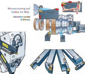

    Many of the MQL setups are intended for machining centers. However, options are available specifically for turning. Vogel Lubrication, Inc., Newport News, VA, offers a delivery nozzle that fits on a turning tool holder, which directs the flow of oil mist toward the cutting edge. The Mircona MQL system, primarily sold in Europe (Mircona AB, Gävle, Sweden), but available in the US, provides toolholders with built-in nozzles to deliver the oil/air mixture to the cutting area.

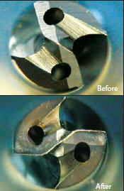

    What can an MQL system do for you? “We do see longer tool life, particularly on deep drilling,” said Hafke. The air/oil mist is compressed passing through the coolant channels in the drill. “As it escapes, it expands and blows the chips out with a very high velocity.” In one test of deep hole drilling in crankshafts, drills with MQL lasted 90 – 100 meters, while those running wet lasted only about 60.

    Guhring drill tip, before and after deep-drilling tests. (Photo courtesy of Guhring, Inc.)

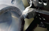

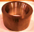

    More exotic and much colder options are also available. The ICEFLY technology from Air Products and Chemicals, Inc., Allentown, PA, directs a stream of liquid nitrogen toward the cutting edge. Liquid nitrogen, at –320 degrees F, keeps the tool and the work very cool indeed, good for faster machining or increased tool life.
    Air Products’ ICEFLY liquifi ed-nitrogen cooling system for machining. (Photos courtesy of Air Products and Chemicals)
    Carbide tube die turned using Air Products” ICEFLY liquid-nitrogen cooling system for machining.
    Mike Epting, business manager for ICEFLY, related a unique application: liquid nitrogen cooling made it possible to reshape tungsten carbide punches and dies by turning instead of grinding, greatly reducing the amount of time required. For example, turning one die took only 15 minutes; removing the same amount of material by grinding normally would take several hours. ICEFLY cooling technology is available from Air Products as a retrofi t, and also is being offered as an option on machining centers from Hardinge, Elmira, NY.

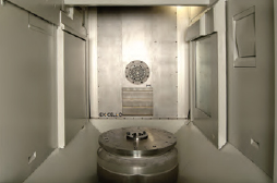

    MAG Powertrain/ Ex-Cell-O optimally arranged work area for “DRY” cutting. Inclined sheet metal surfaces without protruding parts or bolt heads allow dry or near-dry chips to fl ow to the collection area below. (Photo courtesy of MAG Powertrain. )
    Without pressurized flood coolant, the chips don’t get washed away. With both dry machining and MQL you need to make sure the chips clear from the cutting area. In most machines, you will use an air blast to do the job.
    Machines designed specifically for dry machining incorporate chip-handling into their design, providing a free, open path for chips to drop into the collection area. Some machines include a vacuum chip-removal system. Horkos Corp., Canton, MI, takes advantage of gravity for chip removal with its fixture-inverting system. The workpiece is loaded upright on the fixturing table, and then the table is inverted, so the work is machined from below, and the chips simply fall away.

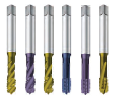

    Emuge taps for dry and minimum lubricant tapping. (Illustrations courtesy of Emuge Corp.)
    Tapping
    “For cutting tools such as end mills, it’s not uncommon to run dry,” said Alan Shepherd, technical director at Emuge Corp., West Boylston, MA. “In taps, people get heartburn over [it]. Usually when you tap holes, you’ve already done a lot of machining and have a lot of money into the product. If you spoil a thread you spoil the product,” he explained. Emuge offers the ÖKO line of taps designed for dry or MQL tapping, as well as tool holders that include a small tube for applying oil mist exactly where it is needed.
    When tapping dry or with MQL, it’s important to have a means for removing the hot chips, Shepherd pointed out. Often, an air blast is used to remove them, or for through holes, the fixture can be designed to allow chips to exit from the bottom of the holes.
