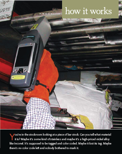

    OK, it’s bar stock, but what is it really?
    Do you have to scrap it? With the price of nickel up around $25 per pound, you could be making some scrap dealer very happy. So what do you do?

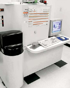

    So, you can cut off a sample of the mystery material and send it off to your local lab for analysis. They’ll likely use some kind spectrometer to do the job. In a day or two you’ll receive a report that tells you what the material is. The cost for the test will probably be $75 to $200, maybe more. And you can use the stock with confidence.
    Historically, spectrometers were big and expensive and delicate, so they had to live in a laboratory. Nowadays, it seems, everything can be miniaturized and ruggedized, and that includes some kinds of spectrometers.

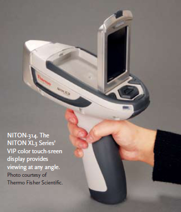

    X-ray fluorescence (XRF) spectrometers are now available in portable, hand-held and small benchtop analyzers you can use yourself in the stockroom, on the shop floor or in the QC department. XRF takes advantage of the fact that every element has a characteristic way it reacts to x-rays.
    When x-rays strike an atom, it emits other x-rays — it “fluoresces.” Each chemical element emits x-rays at energy levels unique to that element. An XRF analyzer focuses a beam of x-rays onto a small area of the sample under test. The atoms in the sample fluoresce and the spectrometer detects and analyzes the energy levels and quantities of the resulting x-rays.
    In a handheld unit, the x-rays come from either an x-ray tube, or from radioactive isotopes carefully shielded within the unit. You place the nose of the instrument on the part, press the trigger, and in less than a minute, the chemical composition and alloy designation appear on the unit’s display. You read the results there and can send them to your computer.
    These small XRF analyzers aren’t cheap — expect to pay $30,000 or more, depending on options — but some shops have found they do pay for themselves. You can sometimes rent or lease them.
    MMR-SRF unit-2. A lab-model x-ray fluorescence spectrometer. (Photo courtesy of Massachusetts Materials Research, Inc.)

    DCI, Inc., St. Cloud, Minn., constructs tanks and storage vessels for dairy, food, pharmaceuticals and similar “sanitary” industries. They work in stainless steel and high-nickel alloys, said Brian Uhlenkamp, vice president of engineering and R&D. Material is absolutely critical to these industries. PMI — positive material identification — is what they’re looking for.
    In 2004, the company acquired a handheld NITON XRF analyzer. “The material comes in and we add a lot of value to it—fabrication, machining. We [bought the analyzer] for liability [and] for our customers to know what they are getting.” Also, he adds, “to verify what we’re getting from our suppliers. We don’t put anything into stock without PMI-ing it.” Uhlenkamp said the analyzer paid for itself in about 18 months.
    DCI has found material mismarked from distributors, and from mills, even when accompanied by certificates.
    On one occasion, DCI needed to produce replacement parts in AL-6XN because the same parts in 316 stainless were failing due to corrosion. It was a good thing they checked the material, because the supposed AL-6XN stock they received turned out to be 316.
    “Buyer beware,” said Uhlenkamp, “because you don’t know what you’re getting.” He said the company has been able to catch about 50 problems of this sort. “People assume bad material or wrong material comes from overseas. We’ve found it’s truly mismarking. We’ve seen things come in marked 304 and it’s really 316. [So] you know somebody isn’t trying to make a buck!”
    A few months ago, DCI purchased another XRF analyzer, so they could have one in the plant and one in the field.
    “We do random inspections on the shop floor. . . and final inspection on key components. Customers want the final report that says ‘that’s what this is,’” said Uhlenkamp. One customer even wants to watch in person when they do final testing with the XRF unit.

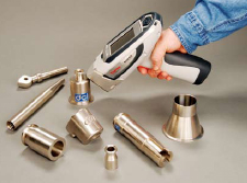

    Witco, Inc., an Avoca, Mich., machine shop, bought a NITON handheld XRF unit a few months ago. It’s been very handy in the stockroom for identifying stock. “We’ve had some where one end is one color and the other end is another color,” said, general manager Kevin Witt. “Now, we’re able to probe and verify [what it is].”
    Once a material analyzer shows up in the shop, folks get creative about how to use it. Witt said his shop has used its XRF analyzer to help “reverse engineer” a broken machine part so they could produce their own replacement. “OK, it’s 4140, check the Rockwell hardness, and [we] made up our own,” he said.

    Your XRF unit can do a lot, but for some analytical tasks, you’ll still have to go to the lab. To determine carbon content in steel or detect infiltrated hydrogen in titanium, specialized instrumentation is necessary. It’s probably a good idea to get acquainted with nearby laboratories, so when you need them, you’ll know their capabilities. Many will welcome you for a visit and give you a tour.
