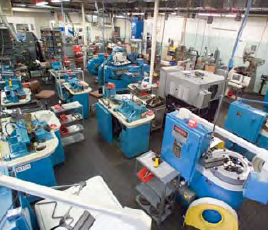

    Thread Rolling Inc. uses a variety of machine types and sizes to roll threads.
    At Horst Engineering & Manufacturing Co., one year old multi-axis Citizen Swiss turning centers and Eurotech multi-axis lathes pump out complete high precision machined components. They turn, they drill, they mill, and they even thread. Yet, in the same small East Hartford, Connecticut factory, Horst Engineering’s sister company, Thread Rolling Inc., uses fifty-year old Waterbury, Hartford, and Reed roll threaders to form external threads with a specialized, yet elegantly simple, secondary process. Not all of their machines are antiques. Much of the equipment has been refurbished, and newer machines are mixed in with old. So it is fitting that they make their home in the most historic section of the old factory, where a fifty-five year old wood block floor symbolizes the sixty-year old family business.
    Thread rolling is a process that has been around for more than one hundred years and there are machines in service that make the fifty-year old ones look young by comparison. Thread rollers come in a variety of types and sizes, but they all use a mechanism where hardened steel dies are matched and set to penetrate with force in order to reshape the material surface of a round diameter into a thread form. A cylindrical work piece or blank is fed into the machine (manually or automatically) and the dies rotate (cylindrical dies) or reciprocate (flat dies) in order to produce threads in a “chipless” forming process. Every thread form, shape, and size has a unique set of dies which are typically ground from heat treated tool steel (typically Rockwell C 58-62) and procured, rather than made in-house.
