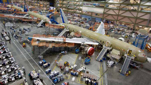

    Top: The Boeing 787 Dreamliner nose section is a single composite part, shown before doors and windows were cut. Bottom: Building the Boeing 787 Dreamliner fuselage sections as full barrels with integrated stringers reduces the number of parts in the airplane, improves overall aerodynamic performance, and helps make the airplane more fuel efficient.
    Composites, by their nature, are created at near net shape and often the only machining required is a bit of milling along the edges and drilling holes. Because the parts can be quite large, too large for available machining centers, much drilling has been done by hand, said Kevin Mayer, aerospace manager at Sandvik Coromant, Fair Lawn, N.J.
