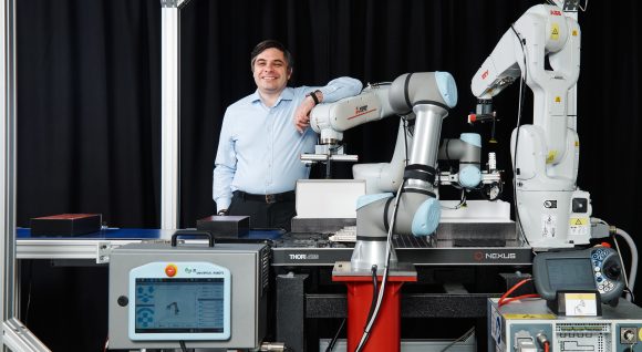

    Today’s guest on the podcast, George Konidaris, is the cofounder of the startup, Realtime Robotics. He is also a professor of Computer Science and the director of the Intelligent Robot Lab at Brown University.
    Right now, programming a robot arm to perform a repetitive task typically requires a robot integrator to program where every joint of a robot should go. It’s a ridiculous and tedious process.
    But with Realtime Robotics’ AI technology, you can instruct a robot to do a task and you don’t have to tell it a zillion steps explaining HOW to do the task.

    George Konidaris: Realtime Robotics is a company that does real-time robot motion planning. We focus on how a robot can automatically generate its own motion. Typically a robot integrator programs every aspect of a robot’s motion in order to accomplish a repetitive task. This means deciding where every joint of a robot arm should go. With our system, you can tell the robot where it needs to put its business end. This is where I would like you to weld, or I would like you to pick up the object over there. We compute the rest of the motion for you.
