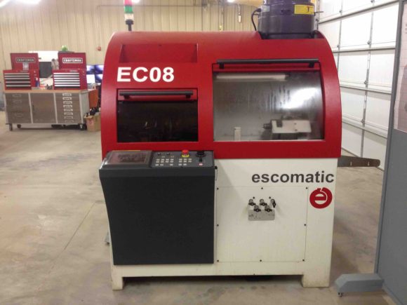

    It all started three years ago, when a machinery dealer in Texas called us about a powerful yet very specialized used screw machine that belonged to one of his good customers. The machine was a beautiful, virtually unused, Swiss made, Escomatic EC08, Mfd. 2013. It was a 6-Axis, CNC, coil-fed screw machine with a max rpm of 10,000 that could machine parts up to 8mm diameter and 100mm in length. It was a powerful machine for the right job, but I would not be shocked if less than 50 models of its ilk existed around the world.

    Chris drove 350 miles to the 200-person town to get to work on the machine. The machine didn’t turn on. But why, if it had run only 400 hours? Because rats had gotten inside it and chewed up wires in the back of its PLC. The rats were gone long before Chris got there, but he could see their old droppings. There was no reason for them to stay there because there isn’t much to eat inside a virtually unused screw machine.
    The PLC control was beyond repair, and we prayed it was the only problem with the machine. I called up Tornos USA, who used to distribute the machine, to purchase a new one. Tornos was helpful, but it took over a month to get the part sent to Texas. Chris traveled back to the machine and we crossed our fingers that it would turn on. It did!
    And we lived happily ever after.
    Sometimes the stars do align. Serendipity leads a machinery dealer in Chicago to the impossible to find customer or the impossible to find machine. In this case, a shiny, red, rat infested but immaculate, coil-fed CNC screw machine from Switzerland, likely sent to a 200-person town in Texas for making bullets (that were never made), then revived by a CNC mad scientist before being sent to the Czech Republic, where it likely was repurposed for medical work.
