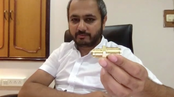

    Mayank shows some parts he makes on the Buffoli for plumbing applications such as compression elbows machined from profiled bar. (See video). The parts are lead-free and he can machine them in 3.5 to 4 seconds. He also shows another part he makes from ECO BRASS with a volume of 1-2 million pieces. He says the tolerances are pretty wide open for brass plumbing parts (see video above). (14:00)
    Mayank says his competitors are now making parts with lead-less brass. He is using high quality ECO BRASS because he is sourcing OEMs in the United States, while his competitors are machining lower quality alloys for India’s domestic brass market. (17:00)
